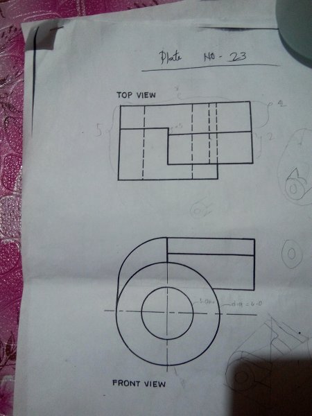

shadowblitz3 Posted May 24, 2016 Posted May 24, 2016 Hi, I am trying to draw an isometric version of this part from first angle orthographic projections. But I just can't do it Quote

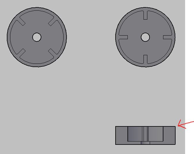

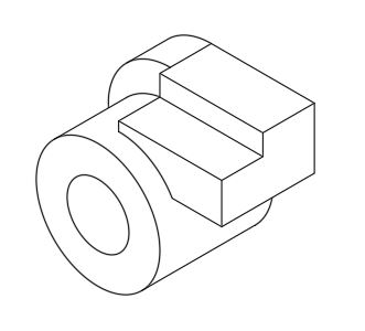

ReMark Posted May 24, 2016 Posted May 24, 2016 (edited) Save yourself the headache and create a 3D model then derive the 2D isometric from the model. So much easier. However, if you insist on doing it in 2D remember you'll need to use the ELLLIPSE command's Isocircle option. OK...here is my rough approximation, given that no dimensions were provided, of what the object would look like as a 3D model using a standard SE isometric view. And these 2D views, derived via the FLATSHOT command, basically support my premise. Hope this helps. Good luck. Edited May 24, 2016 by ReMark Quote
ReMark Posted May 24, 2016 Posted May 24, 2016 Thought these two images might be of use. One with and one without hidden lines. Quote

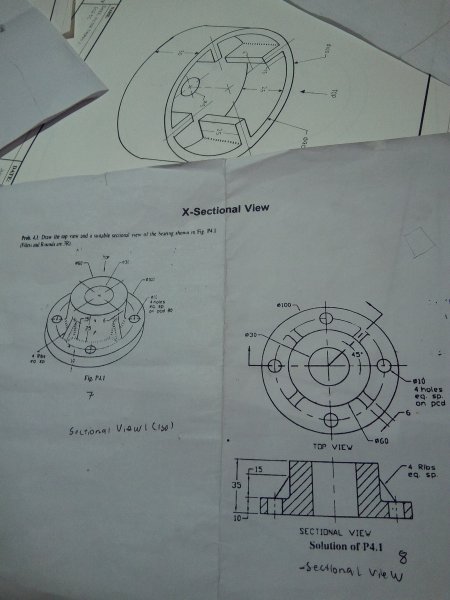

shadowblitz3 Posted July 12, 2016 Author Posted July 12, 2016 Shadowblitz: Have you made any progress on your 2D isometric? No response? Did you decide to drop the course instead? I'm terribly sorry for my uber late response but yeah thanks a lot for helping out, also I managed to pass that course but now Im now taking its prerequisite and our dick of an instructor never really teach us anything, just hands out plates after plates we're now at making cross sectional views and have a new plate that I need some help on lol Quote
ReMark Posted July 12, 2016 Posted July 12, 2016 (edited) So what is the problem? Should be easy to create a cross section using the SECTIONPLANE command. Or, if you want to, you can create the 3D model and cut the section(s) yourself using the Object or the Surface option of the SLICE command. You should learn/practice all options so you have a good understanding of which works best for any given situation. Edited July 12, 2016 by ReMark Quote

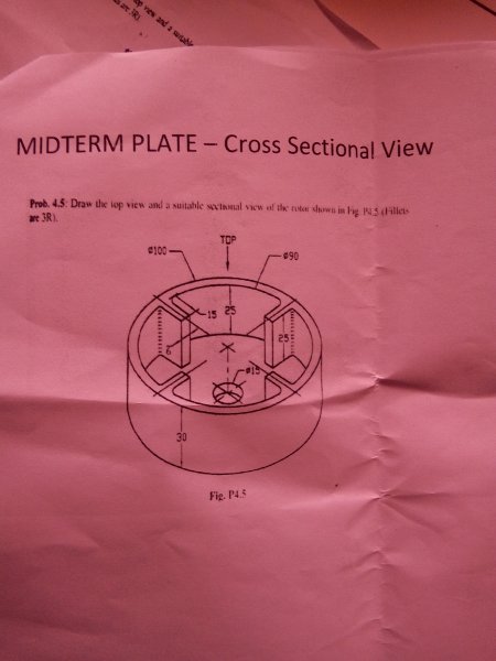

shadowblitz3 Posted July 12, 2016 Author Posted July 12, 2016 drawing the top and sectional view like this thanks for the tips, will try to practice/learn more Quote
shadowblitz3 Posted July 12, 2016 Author Posted July 12, 2016 also we have to rotate the figure so the x becomes a vertical cross Quote
ReMark Posted July 12, 2016 Posted July 12, 2016 also we have to rotate the figure so the x becomes a vertical cross You should know how to rotate a 3D model already. How to rotate a 3D object around an axis...https://knowledge.autodesk.com/support/autocad/learn-explore/caas/CloudHelp/cloudhelp/2016/ENU/AutoCAD-Core/files/GUID-8E0010A3-EF81-4FA8-A0BF-B0961910DFD8-htm.html Quote
ReMark Posted July 12, 2016 Posted July 12, 2016 drawing the top and sectional view like this[ATTACH=CONFIG]58565[/ATTACH] thanks for the tips, will try to practice/learn more AutoCAD SECTIONPLANE command... https://knowledge.autodesk.com/support/autocad/learn-explore/caas/CloudHelp/cloudhelp/2016/ENU/AutoCAD-Core/files/GUID-3AC2CA12-2085-4782-B66A-7964B73B55EA-htm.html Quote
ReMark Posted July 12, 2016 Posted July 12, 2016 Two top views and a section. In this example I copied the 3D model then created a section using the SLICE command > Surface option. I used the 3DROTATE command to rotate the section into the correct position. Visual style = Conceptual. Another link for you re: creating sectional views using the BASEVIEW command. Note that this command places the blocks that are created in a layout and not in model space. You could also use the combination of two commands SOLVIEW and SOLDRAW to do something similar but I think BASEVIEW is much simpler. http://www.cad-notes.com/autocad-2013-create-section-and-detail-views/ Quote
shadowblitz3 Posted July 12, 2016 Author Posted July 12, 2016 Two top views and a section. In this example I copied the 3D model then created a section using the SLICE command > Surface option. I used the 3DROTATE command to rotate the section into the correct position. Visual style = Conceptual. [ATTACH]58566[/ATTACH] Another link for you re: creating sectional views using the BASEVIEW command. Note that this command places the blocks that are created in a layout and not in model space. You could also use the combination of two commands SOLVIEW and SOLDRAW to do something similar but I think BASEVIEW is much simpler. http://www.cad-notes.com/autocad-2013-create-section-and-detail-views/ again thanks a lot for your help, will really try to learn all this and make them myself for a change Quote
