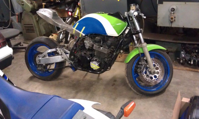

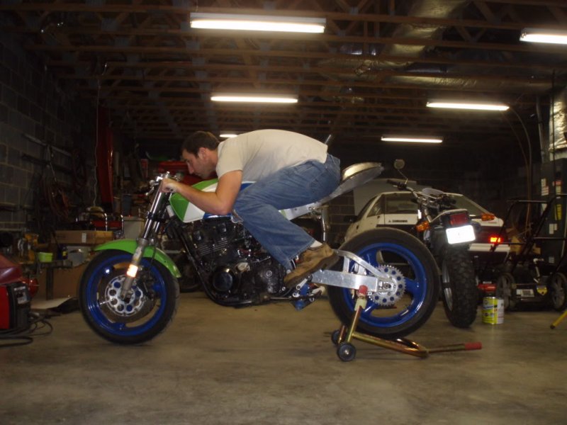

Supermotos are the best unless you spend a lot of time on the highway. Hypermotos are the next. Ive had all kinds but I prefer the track. I gave up street riding when my kids were born. I still have a gpz750 thats highly modded. 320lbs. Turbo, suspension from a gsxr etc. But its a garage ornament. I had a modded drz400 for 10 years and that was a great all around bike. Getting way off topic now :) pm me if you wanna chat bikes.

ill crib note it here for you. Its an exercise in engineering for me. I had it from 530 to 400lbs fully street legal. Lights, horn etc. I had it featured in RAPID bikes mag(streetfighter). Started stripping it more and more making it minimal. Subframe is 3/4" thinwall DOM. tiny battery. Full custom harness, minimal gauge(actually worked on a gps based speedo) etc. I've hacked the frame and minimized everything i could. I plan to do a total loss system, dry clutch and a few more things. Going total loss has been tricky since i have an FI setup on it. Also dropping the starter for a bump start setup. The dry clutch setup will allow for better turbo oiling. Its just one of those things that will never be done. it was my first street bike when i was 18 and i've hung onto it since. I don't really have any great pictures of it and its always in a project state cause i have no time. I was building a new tail section last time i touched it. There is a subframe under that tail and it does support me, holds a battery and a few other things :) Its 325lbs with turbo/dump pipe, battery etc. If i go no starter, total loss, dry clutch i think under 300lbs is within reach. 80hp NA and about 120hp on turbo.
Jeeze. That is.. really nuts. For all that work I'm surprised you've not retro fitted some inverse forks. Regardless, at 320 lbs I'm sure you can throw it into a corner with hardly a thought. In addition to that your power to weight ratio is liter bike territory. Are those numbers wheel or crank? That's a nice little monster you've made. What year is the frame/engine?
The usd vs conventional thing was planned. These bikes were nicknamed "flexi flyers" back in the 80s. Usd forks are too stiff. I like the feel of the chassis and didn't want to go too crazy bracing it. Only change might be bandit fotks. I dripped the front 2 in. Its sub 23deg rake. 3in trail and 55in wheelbase. It started as an 83 gpz. The gsxr stuff is from 89 to 05 slingshot stuff. Mix n match. Hp is wheel. I dyno tuned to 80hp on carbs. Turbo powee is an estimate as its theoretical
