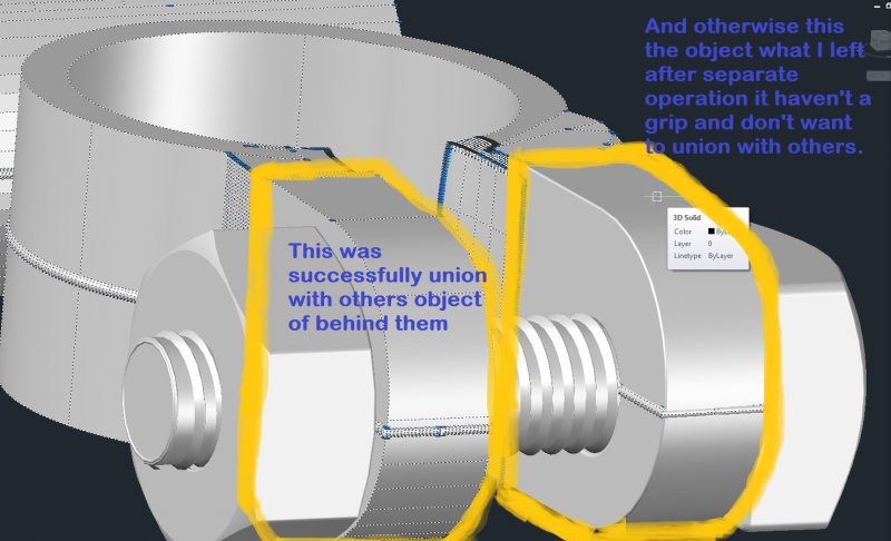

How do we could seperate the object have been subtracted, as keep as solid object ???
Any way the another one object I left after I separate there is other one whould haven't a grip and won't tobe union with others object. Why and How to make as a normal profile solid?
#I'll attach the pict to make you definitely of my sample file of I drawn!
Edited by Deby Ferdian
Put a question emoticon!

If you are talking about the bolt why would you union it to the clamp?
No.. no.. no.. The bolt, that is an another component else by separately I do this with care and look be carefully ReMark! * The question is ~

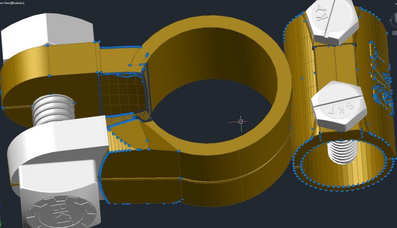

Why the other calmp hand won't be unity as one as united object by union command? * This one object is the result by separate operation command have left with the couple of the another clamp hand else one
#see this ...
Add more some words!
Without a copy of the drawing I can't say for sure.
What is that raised seam you have at the midline of the clamp?
Yeah.. yeah.. Yes of course I do pleasure it with full my heart and happy if you do can a help and share opinion and ideas with me. But I think I'm getting a mistake after I finished with the separate opration and with accidently I just was do union to clamp hand was alone earlier, now have been united with the bolt. And I can't do separate it more I don't know. Why??? :oops:
I do not know for sure but as I see in it's original form (not the photo or picture) but it looks like and maybe it was mold seams of the object at the bottom and with the object that is on it. It's like weld probably!
