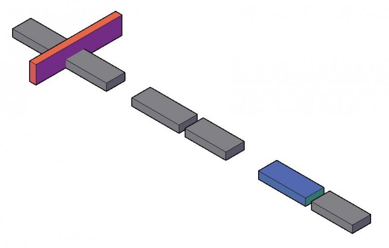

Deby Ferdian Posted May 20, 2016 Posted May 20, 2016 When we subtract more then one object they will become united object and solid profile. "Question is ~ How do we could seperate them as keep as solid object if we want to make a revision or editting for example here. I want to move that object one of them which were been a united object onto another coordinates ??? #sorry about my english experience.. Quote

ReMark Posted May 22, 2016 Posted May 22, 2016 Yes.. but it's like the command still not available for Autocad 2013. That does not sound right. The command should be available on the Edit Solids toolbar at the very least. Quote
Deby Ferdian Posted May 22, 2016 Author Posted May 22, 2016 Ooo.. ya, ya, ! I've late to realized this all. You mean the "separate" command at the solid edit. Right? Quote

ReMark Posted May 23, 2016 Posted May 23, 2016 I believe the OP was trying to separate two non-joined solids that AutoCAD was treating as a single entity. Quote
ReMark Posted May 23, 2016 Posted May 23, 2016 An example.... Starting on the left. The reddish rectangle is subtracted from the gray one. The result is in the middle. AutoCAD treats those two remaining parts of the original gray rectangle as a single entity. Invoke the SEPARATE command and pick the entity (either side; it does not matter). AutoCAD breaks the invisible bond between the two objects (result is on the right) and now the user can edit either on an individual basis. Got it? Quote
rkent Posted May 23, 2016 Posted May 23, 2016 OP, use Interfere, when the dialog pops up at the end unselect the box check marked to Delete interference objects created on Close. Once you close then you can use the created solid to subtract with. About the same amount of steps as making a copy of the object and subtracting one of those. Quote
