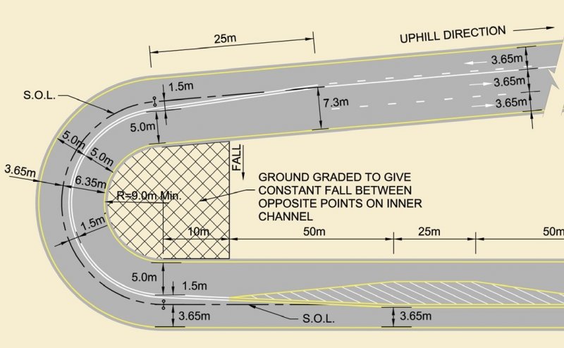

Hello anyone;
At the curve (etc. Hairpin bend) lane width will increase as shown example
Is that possible to do by civil3d Alignment & Alignment offsets without doing by Autocad
Siva
If I'm not mistaken you can just create a superelevation assembly then use an alignment to pull to your offset
