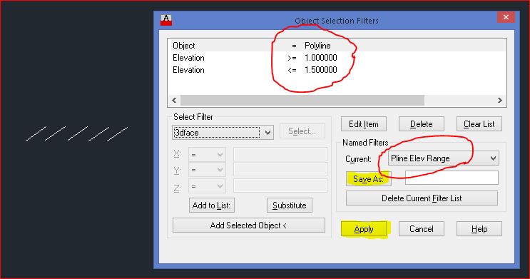

Another non lisp approach would be using the FILTER command.
The way I set this up, the FILTER is actually searching for all Polylines with Elevations in the RANGE from 1 to 1.5, but that can be easily altered.
Once you set up such a Filter, you can save it as a preset, so the next time you need it, all you need to do is to select it from the dropdown Named filter menu.
QuickSelect will not allow you to do a range like this, or multiple elevations in one search. :|
