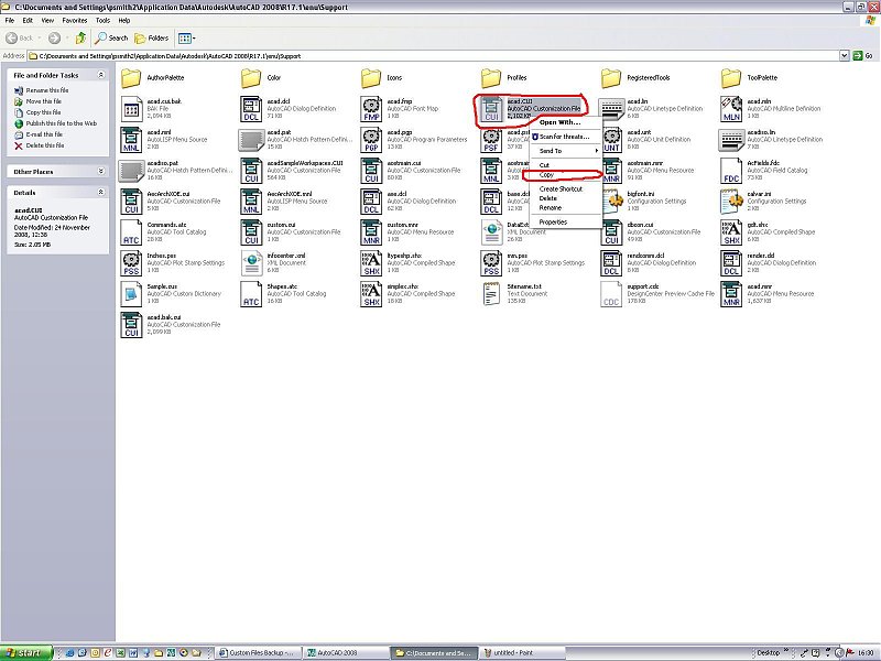

go into C:\Documents and Settings\YourUsername\Application Data\Autodesk\AutoCAD 2008\R17.1\enu\Support
select the Acad.CUI file, and COPY the Acad.CUI to a different folder, in my case i got mine copied in My Documents.
