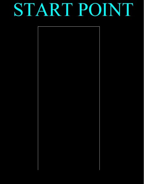

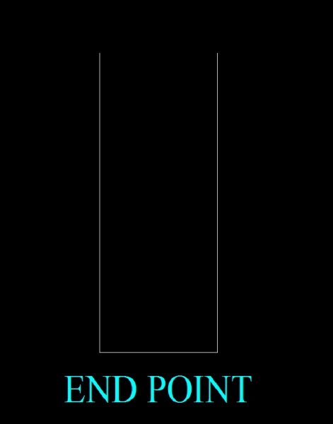

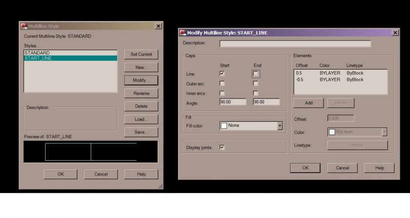

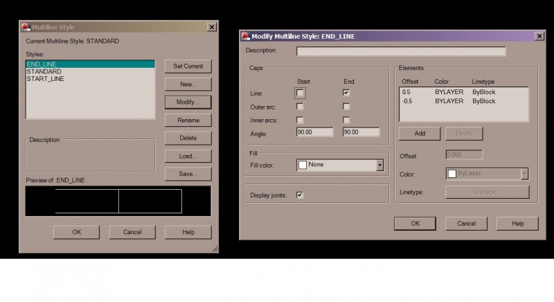

CAD USER Posted May 14, 2016 Author Posted May 14, 2016 (edited) in MLSTYLE start line means, start line will be remain at start point, end line will not be remain in this lisp or in mlstyle, in MLSTYLE end line means, end line will be remain at end point, start line will not be remain in this lisp or in mlstyle, Images and lisp routine is attached. in short, in the one lisp routine I need only start line in another lisp I need only end line thanks in advance.. START LINE.LSP END LINE.LSP Edited May 14, 2016 by CAD USER Quote
