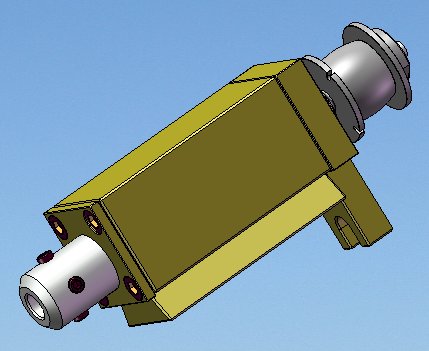

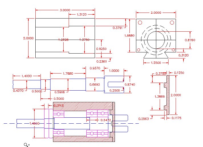

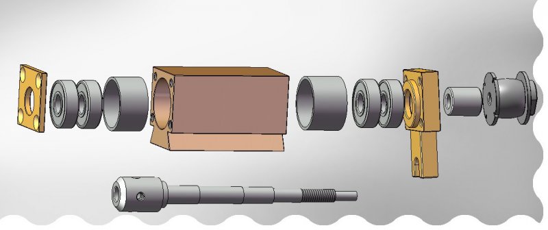

Uma, another user was having trouble uploading some images for you but has graciously provided some info on a proven design. See below.
Ms Rostikovitch,

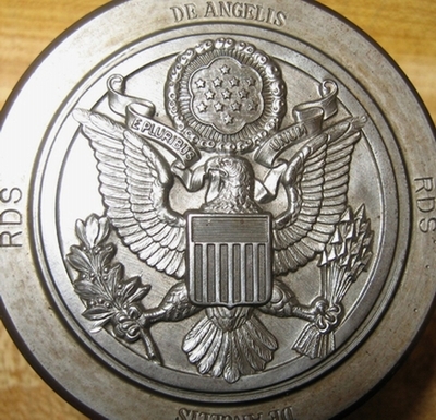

I have enclosed a 30 year old engraving spindle design. The accuracy of this design is used in the engraving industry mostly on engraving-reducing machines used by the United States Mint, to produce the dies used to make our metal currency. It is of course also used in the jewelry industry and has been since the turn of the century.
The design employs two angular contact bearings, installed back to front, in the front, and one axial bearing in the rear. As you probably know bearings are ranked by class number, 1 class being the least and 8 or so class being the most accurate. The higher the number, the more accurate the bearing, and of course the more expensive as well. Also enclosed in an image of a master hob, engraved in RDS Oil-Hard tool steel, to demonstrate the fineness of detail that can be accomplished using this design. I believe 3-class bearings were used in this spindle. An important point to be recognized here is that for the ultimate in accuracy, the cutter should be sharpened while in the spindle. The cutter grinding fixture has to accomodate spindle and all. The cutters used on this type of engraving is a two flute conical ball cutter, and they are sharpened to .004" in diameter, or course under microscopic observation.
