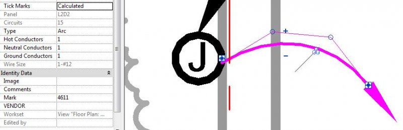

One of my coworkers is having an issue where his arc wires are automatically being drawn with more than 1 vertex on them, and none of us have been able to figure out what's the problem (the rest of us don't have it).
I suspect it's a problem with his installation, but I'm curious if anyone knows of a setting somewhere that you can modify to adjust the default # of vertices that Revit provides on arc wires whenever you draw them.
It's ultimately not a big deal, but he is pretty frustrated with the fact that he's not drawing arcs so much as spline-like objects and they end up looking ugly in his view (he's also annoyed by manually removing the extra vertex on every wire 8)).

Not sure when the feature was added (i.e. if it's exclusive to Revit 2016 or if earlier versions have it as well), but you can add vertices (control points) to an arc wire. (Right-click on the wire, and select "Insert Vertex" or "Delete Vertex"). In his case, though, the default arcs already come with 2 vertices/control points, whereas in Revit 2014 (and everyone else's version of 2016), it adds just one.
I've seen him do it and he's really 1. drawing arc wires, and 2. clicking only 3 times (first device connector, empty space, second device connector). And yet, the resulting wire has the extra vertex for some yet inexplicable reason, while the properties still list it as an arc wire.

I attached a screenshot to my post above. I can achieve that result by manually inserting a vertex after drawing the wire, but his arc wires come with it by default.
