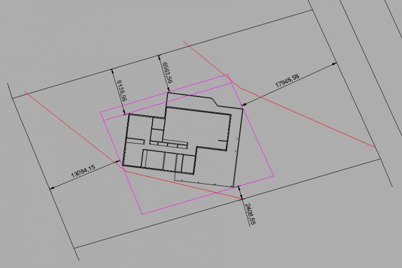

NAS 78 Posted May 6, 2016 Posted May 6, 2016 Hi, i have been given a survey plan that i have to add a floor plan of a house to. i have the distance from the boundaries to the corners of the house. i have tried offsetting the boundaries by the respective distances an then using the ALIGN tool but it only snaps the house to one line. any help would be greatly appreciated. Thanks. Quote
ReMark Posted May 6, 2016 Posted May 6, 2016 (edited) So in other words you have been tasked with creating what is called a plot or site plan. I'd suggest attaching a copy of the drawing to your next post and someone here will take a look at it and get back to you. An image is of no use; it has to be a .dwg file. BTW...what units are you working in (metric or imperial)? FYI - Normally plot/site plans show the footprint of the building and not the actual floor plan. Floor plans are also usually done at a much larger scale than plot plans. Plot/site plans are primarily used to show the relationship of a building to the surrounding property lines. It will also show the setback lines as called for by city zoning regulations as well as such features as driveways, out buildings (sheds and garages), fences, retaining walls, and locations of miscellaneous features such as wells, nearest street(s) and property markers (i.e. - pins or stakes). Edited May 6, 2016 by ReMark Quote
RobDraw Posted May 6, 2016 Posted May 6, 2016 i have tried offsetting the boundaries by the respective distances an then using the ALIGN tool but it only snaps the house to one line. This probably cannot be done in one step. Move the house so that it is the correct distance from one of the boundaries. Then move it along that offset until it meets the other offset. Quote

eldon Posted May 7, 2016 Posted May 7, 2016 One has to realise that surveys to property are not inch (or millimetre) perfect, and one usually has to do a best fit. In the attached picture, I made the two corners to be parallel with their boundary, and split the difference thereafter each way. But one could play around with the shape much more, but would it be any better? Quote

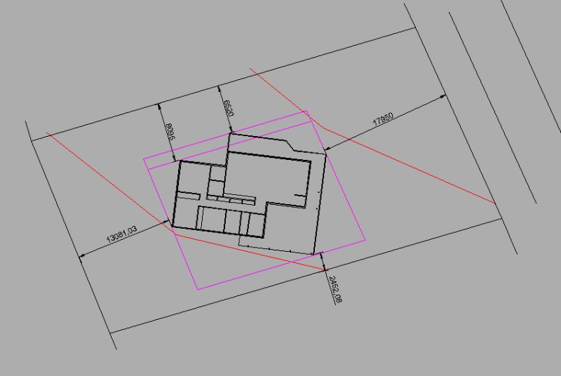

eldon Posted May 7, 2016 Posted May 7, 2016 I had another go, but perfection seems to be out of my reach. Quote
ReMark Posted May 7, 2016 Posted May 7, 2016 Are the distances from the corners of the house perpendicular to the property line? Quote
eldon Posted May 7, 2016 Posted May 7, 2016 Are the distances from the corners of the house perpendicular to the property line? I took the dimension from each corner, perpendicular to the nearest property line. I presume that is what was intended. Quote

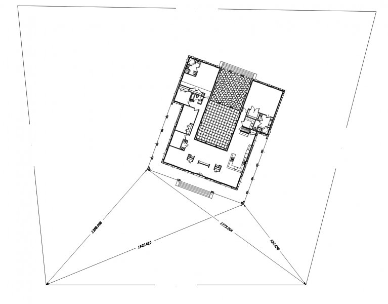

Dana W Posted May 7, 2016 Posted May 7, 2016 Is this an existing structure, or is it yet to be built? If it is existing, why didn't the surveyors furnish triangulation distances for at least two corners of the house? It is inexcusable that they did not. The information you have is not really going to lay the house in place all that accurately. Too much nudging, fudging, and twisting by eye going on. I have two paychecks that say the distances were measured with a surveyor's tape reel running through bushes, and over rocks, and around trees. Every existing house and lot I ever field measured were drawn up using triangulating distances from at least two adjacent property corners, to two corners of the house. These distances were not however, on the final drawing. At minimum. how far off the BRL the house sat and distances to the front, and one side property line, were on the drawing. It depended on the purpose of the drawing, how much info was on it. Quote
NAS 78 Posted May 7, 2016 Author Posted May 7, 2016 yes i took it to be measured perpendicular to the corners also, i didn't realize that it need not be exact, that will help a whole lot, thanks so much! I think i can move forward from here. Quote
eldon Posted May 8, 2016 Posted May 8, 2016 i am not quite sure how this happened, but if you look at the floor plan, and add the dimensions on the second line down, the overall dimension on the top line is 185 short. (My summation was 17735.) Coupled with the fact that the direction of the boundaries drawn is not as the figured whole circle bearings, I think that you are near enough. Quote
Dana W Posted May 8, 2016 Posted May 8, 2016 Not only will the lot "as built" measurements be a little "flexible", most houses are well out of square. Quote
