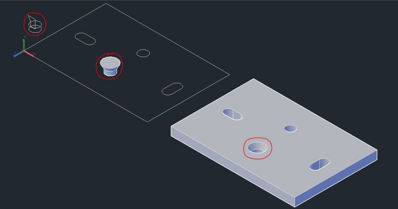

Hello, i am using autocad 2017, and i need to create a countersink. I would like to know if it is possible in autocad 2017, i couldn't find the tools that would allow me to do so. I tried chamfering but it is not giving the desired results.
The holes where i need countersinks are the holes in the middle.

Do i need to acquire inventor or another autodesk program designed for this purpose. Thank you.
Chamfer should do it, are you watching the command line as you chamfer?

My aim is to make a very particular countersink with a specific angle and a specific length. Can it be done with this level of precision?

You could always create a half profile of what you need, revolve it then subtract from your 3D model.

As per SLW and ReMark, there are different ways it can be done, and yes, you can definitely do it with Autocad.
John: A quick example (entirely a figment of my imagination of course). I think you are smart enough to grasp the concept.

I didn't know how to create such a solid too either and i have done what i needed to do, thank you for the help
