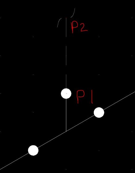

Just looking for a basic lisp routine that I would call a continuation, not really sure what to call it, so its hard to find something that exist. Anyways, I want to draw a simple line with 2 points on a hidden layer and then insert a "spline" on the end prompting user for rotation angle. The "spline" is a block on our server. Would eventually like to add the ability to get isoplane and rotate that spline to match the isoplane. See snap shot:
Looks like the symbol one would use to show a pipe break. Why bother with a lisp routine when a block would suffice?
I guess I just wanted to expedite the line, the block, the rotation, as well as the layer switching and stuff. At the moment we draw a line 0.5 units in whichever direction the line is to be continuing. Next we type "1" which is the line break symbol insert shortcut command. Then insert it at the end of the line and rotate accordingly. Finally we select all and put on hidden layer. It doesnt take but maybe 10 seconds in total but I was just having some downtime and was thinking of a routine that could do all that for me.
Nothing wrong with your request. I was just curious.
I was thinking something really simple line this. Still not too familiar with getting and storing points, otherwise I would written it to only be 2 points, storing the second point, then inserting the break symbol at p2 upon completion of drawing the two point line.

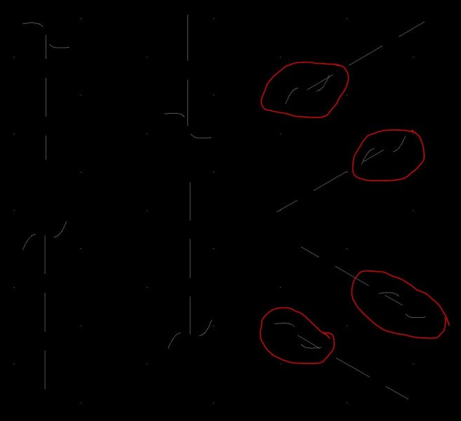

What I would like to do now is actually write something in here that gets the current isoplane and actually rotates my spline so it is on the same plane as my crosshairs. This is so when we type our continuation line (which I will work on coding into this routine next) it will look neat and on the same plane. See image:
Small update, this is what I have so far. It seems to work perfectly for vertical continuations but as soon as i go either way in left or right isometric it doesnt properly rotate the break. I am trying to figure where and how to code that piece. Still in development if someone wants to chime in.
