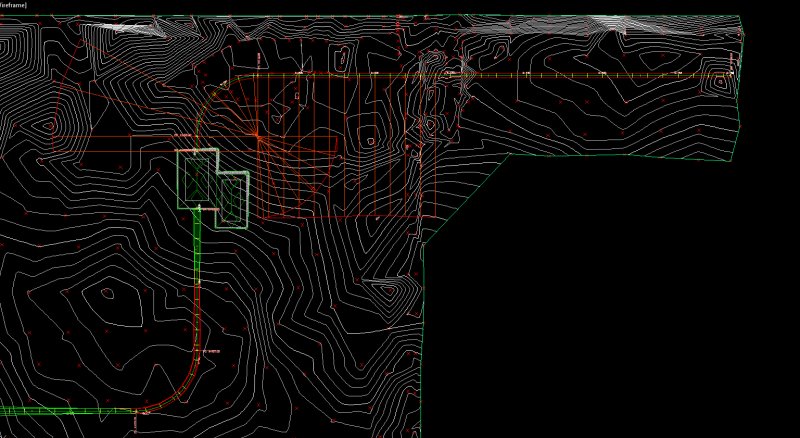

Good Morning friends .... I need a help with this drawing in civil 3d 2014 .... I do not understand why the broker creates the top of the drawing that way ... as if below the original surface. .... I have two days trying any coasa and nothing to fix the problem ..... thank you very much for your Help and your Time .....
Note:try to send the file but is greater than the limit that allows me page .....

Have you created a profile of the design corridor? (new road)
Create an existing profile using existing surface then place what would be your center line of new roadway
with vertical curves etc.
