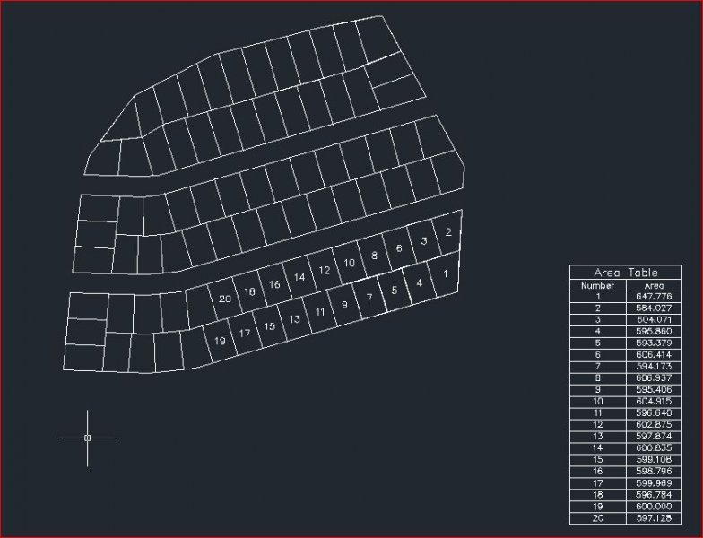

Hi Guys,
I have a 1200 lots land similar to shown in the attachment. The poly lines are not joined. I need a way to find the enclosed area of each lot and the area needs to be shown as a text on the drawing… Any suggestion to write a script or lisp to work this out…
You save a lot of my life
Cheers

create separate hatches and recreate the boundary on a separate layer maybe?
EDIT :
just done as what I suggested in 5 mins :)
since it is already a closed polyline...
you can easily get the areas of each one of them

“create separate hatches and recreate the boundary on a separate layer maybe?”
Thank you… But that will take pretty long time… What I thought is use
“Boundary” command, select enclosed area, check the created polyline, add the area text.. ( but these things should happen in script than doing it manually as it would take long time).. Not sure how to write it
Check out this lisp by Lee Mac, there are others on his spectacular website, if you need to generate a table, for instance.
The total area of multiple lots is an option in this and one of his other area lisps, with the table functionality.
http://www.lee-mac.com/areastofield.html
Thanks Lee! :beer:
You are always there to help out Dadgad... Will check it out and get back to you...
Lee Mac is awesome!
No need to use the Boundary command, just fire up the following lisp by Lee Mac...
http://www.lee-mac.com/arealabel.html
...first you will need to download it to your computer, and LOAD it, of course, and then jump right in, with AT at the commandline.
Pay attention to the commandline prompts!
Remember if this is not what you want, there are additional options available, as well as other AREA specific lisps on Lee's site.
Lee Rules! :beer:

see my attachment. I have closed those unclosed areas in your drawing thru hatch and recreate boundary.
then you can use Lee's lisp to quickly get the areas of each lot.
Unfortunately Lisp has some Issue when its amended... Still I am happy using Boundary AT the moment as this itself saving lots of time... Thanks to all helped and Lee
Thats what I was using Dadgag... BUt AT Lisp... That looks good where I can find that...?
AT is the commandline entry to start Lee's lisp, once you have downloaded it to your computer, and used the LOAD command to fire it up.
Sorry, the lisp I used was another one of Lee's, here is the link...
not the one that I posted earlier.
What you see in the screenshot took less than a minute to do.
Watch the little video on Lee's site, and read what he says about the options available on the description of the lisp.
Pay particular attention to the last paragraph Additional Features!
Thanks Lee! :beer:

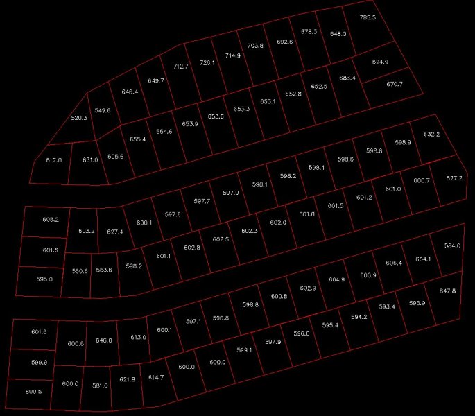

Hey give this a shot for your areas that you wanna place inside each lot. Worked in 10 seconds for me.
T 07/08  www.cadalyst.com/code
;;; Tip 2292: AreaRon.lsp    Area of Closed Polylines    (c) 2008 Ronald Maneja (Wizman)
;;; PRODUCES TEXT CONTAINING AREA OF  SELECTED CLOSED POLYLINES
;;; AND PUTS THEM IN AREARON LAYER
