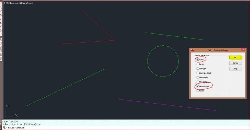

My first question is: AutoCad 2016 (student ver.) is there a possible way of selecting one line (property RED) and then have a command that could select all the lines in model space that have the color RED??
Could it be done with using any of: linetype/lineweight/line color
***IF WHILE IN MODEL SPACE EVERYTHING IS ONLY "LAYER 0"***....meaning I didnt use the layer properties
what if the RED lines are a block? Can I SELECT one block and then USING a SELECTION TOOL it could select all the blocks??

The command you want is SELECTSIMILAR.
Follow the commandline prompts.
You will need to use the SEttings option to define the object types which you are looking for.
If you were trying to select specific blocks you would want to use the NAME option.
SELECTSIMILAR or QSELECT should work, you may also want to look into filters for future work.

Qselect can be used for more than one criteria by first going through to select one type of object, hit enter to start it back up, pick the box at the lower left for append to previous, pick another type of object, and go from there.
I use it when I need Text and Mtext, as a common example.
Filter is more powerful, no question.
