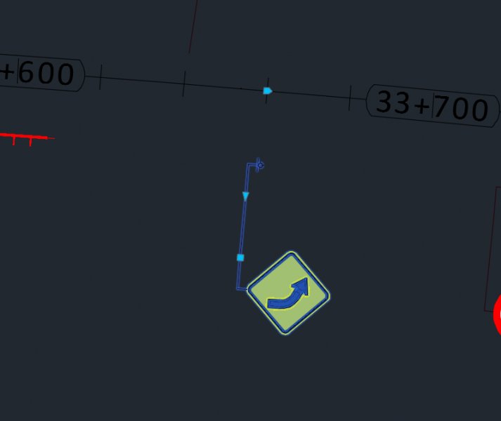

Basically I want to reference those traffic/road signs to the aligment.
If I lookup for block A1 (which references to a traffic sign) I want to know which station (e.g. 33+660);
PS.: I use dynamic blocks
I tried to do that manually, exporting data both from the alignment and traffic signs to excel. But sometimes the X,Y coordinates don't match exactly because the signs are not ATTACHED to the stations.
Any help or ideas on that would be welcome!
Cheers
Using the VL closest point to would work out the sq off the alignment point then you can use vl get distance at point , will try to find some example code.
Here is a short bit that is the heart of a bigger code, pick a pt pick a pline returns the answers
