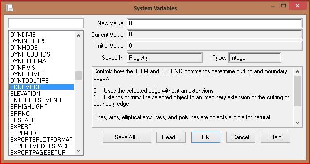

Dadgad Posted April 28, 2016 Share Posted April 28, 2016 Here is a screenshot from my SYSVDLG dialog, explaining the options available, in 2013, not sure if they will be the same in AutoCad 2004. Quote Link to comment Share on other sites More sharing options...
benhubel Posted April 28, 2016 Author Share Posted April 28, 2016 I wasn't aware that such a dialog existed, and so I thank you for the info. I already looked up this particular variable online, but for the sake of learning other things, I will be reading the hell out of this dialog box. It looks the same in Autocad 2004, but for some strange unknown reason it just crashed my Autocad session. It was just sitting there with the SYSVDLG box open as I was typing this. Quote Link to comment Share on other sites More sharing options...

Dadgad Posted April 29, 2016 Share Posted April 29, 2016 I wasn't aware that such a dialog existed, and so I thank you for the info. I already looked up this particular variable online, but for the sake of learning other things, I will be reading the hell out of this dialog box.It looks the same in Autocad 2004, but for some strange unknown reason it just crashed my Autocad session. It was just sitting there with the SYSVDLG box open as I was typing this. Interesting, I didn't think you would have it in 2004, as it is still called an Express Tool. It is in incredible resource, and will help you to troubleshoot and optimize your system variable settings, while teaching you plenty about what goes on in the belly of the beast. Using your keyboard cursor arrow you can just scroll down through the list, until you see something that catches your eye, no need to stop and click each one. Thanks Miller! Quote Link to comment Share on other sites More sharing options...
