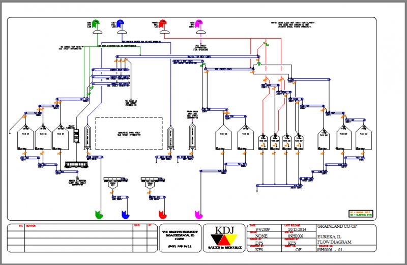

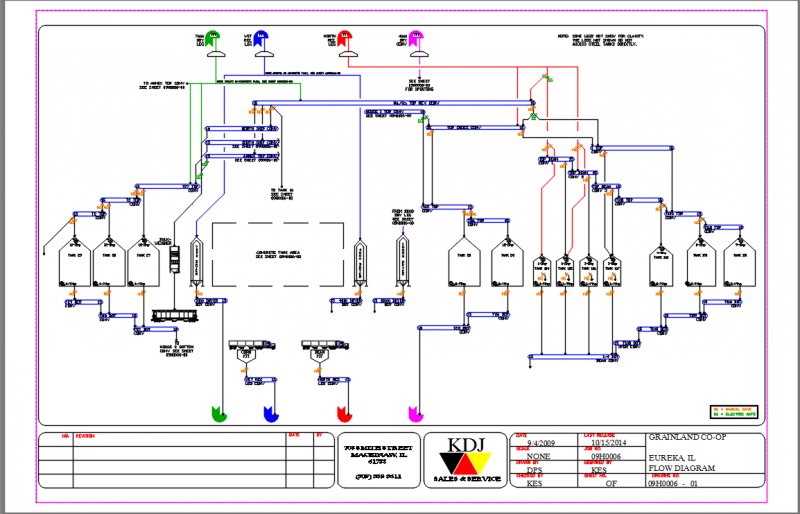

dstille Posted April 22, 2016 Posted April 22, 2016 (edited) When I view my drawing in my view port it looks fine, also, when I do a print preview it looks fine. The problem is that when I actually print it the print is offset and it gets cut off about 2/3 of the way across the paper. Edited April 22, 2016 by dstille To add Attachments Quote

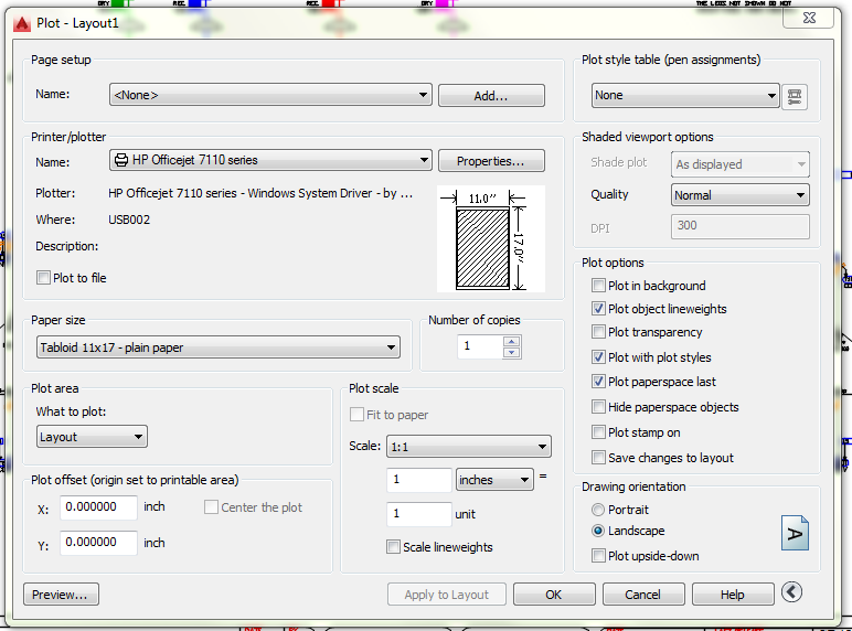

ReMark Posted April 22, 2016 Posted April 22, 2016 You are printing from a layout is that correct? Can you provide us with an image of the Plot dialog box so we can view what settings you have chosen? Quote
ReMark Posted April 22, 2016 Posted April 22, 2016 I think it may have something to do with the fact you have specified Tabloid 11x17 as the paper size. Is there an option for Ledger size paper? Is there another printer/copier in your company that utilizes 11x17 paper you can send the print to in order to compare results? Quote

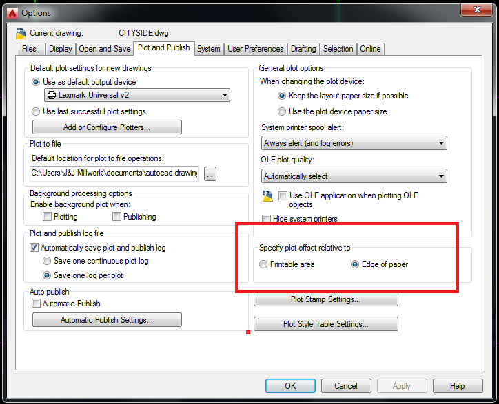

Dana W Posted April 22, 2016 Posted April 22, 2016 Your paperspace view is not showing the printable area (dashed line rectangle) You MUST know where it is, otherwise the viewport may be outside of it. I notice that you have your plot offset set to 0,0. What is the setting on your Options > Plot & publish tab for the offset relationship? See the red rectangle in the attached image. The combination of your printable area not showing, and a conflict in the offset settings may be causing your issue. Quote

RobDraw Posted April 22, 2016 Posted April 22, 2016 It looks like a landscape vs portrait issue. Quote
rkent Posted April 22, 2016 Posted April 22, 2016 In the plot dialog pick Properties next to the printer/plotter name, pick custom properties. Go the the Features tab and make sure Actual Size is picked. Maybe while you are there go to Paper/Quality tab and make sure those choices are set properly. Quote
BIGAL Posted April 22, 2016 Posted April 22, 2016 My $0.05c I notice that you have your plot offset set to 0,0. check your lower left is 0,0Your layout window is a true 17x11 as you have scale set to 1:1 what happens with FIT as a test. See this when people move the title block and our autoplots then dont work. Quote
