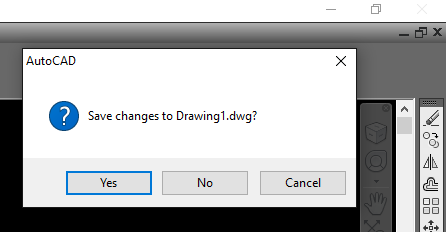

I'm pretty tired of the " save before closing" message , I have to close and re open dwg's very often and i'm always aware of what im doing so I really want to get rid of this.
How can I do it? i googled around and I just found crazy complicated LISPS or adjustment in the registry.... isn't it there a straightforward way?
many thanks!

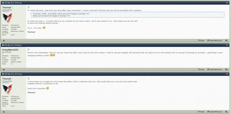

thank you, i checked thread but as i thought, it gives for granted that one knows where to put the code and how, and i dont.
can you tell me where to put this code? i need a step by step guidance if possible

there's nothing, here's how the thread ends, " I recommend you to depend on the Visula lisp editor which is attached with Cad , that would help you a lot and much easier than notepad without a comparison at all . "
I need a guide step by step on how to upload the code. it's not enough to know that i can be done with the visual lisp attached with cad.
sorry, i'm a beginner.

The solution by Tharwat is given in post #2 of the thread I provided the link to. I know because I checked it...twice.
Lee Mac's tutorial explains in clear and concise detail how to load and run a lisp routine using any of three methods.

I don't understand.
If you open a drawing and the drawing is changed, it's GOING TO ask you if you want to save changes.
This is standard operating procedure in any application.
If you're specifically talking about "Drawing1.dwg", then REMOVE whatever startup code you have running that is making a change to "Drawing1.dwg" (And causing DBMOD /= 0)
As soon as you do that, "Drawing1.dwg" will close without asking you to save, because it won't be modified.
