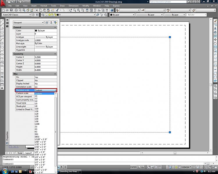

Just select the viewport you want to set the scale for. Then open up the properties window and select a scale from either the Standard or Custom Scale menus.
This is how it appears in AutoCAD 2009. Your's may be slightly different but by setting the scale in the viewport you will achieve what you want. You can set different scales for any viewports so don't be shy about playing around with this. You will find like I did that this is one of those hurdles in using AutoCAD that once you understand it, many other tasks will become easier.
