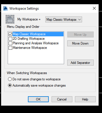

workspace.pngAre you saving the workspace after you set it current? My image is from 2016 but should be the same as in 2011. Also are are SP installed?
Just a further suggestion save a work space as your own like "cat3appr" set current and save, I have the Auto save turned off so it can not be accidentally changed. If I make a change then I force a save. By having your own workspace you can always go back the out of box settings if something really stuffs up and start again.
thanks guys, I wish it was that easy... i've already tried that, see screenshot. My settings are always like this.

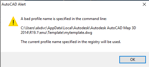

I did modify the target in the properties icon of CAD and i added a template which was on classic map workspace and no ribbon. it just didn't work. first of all, i got the error attached , and second, the ribbon is still there.

/w is the Command Line Switch for Workspace see reference at: http://help.autodesk.com/view/ACD/2016/ENU/?guid=GUID-8E54B6EC-5B52-4F62-B7FC-0D4E1EDF093A
Put it at the end followed by MAP CLASSIC or whatever the name of the profile you want. Best to click Rename… on the Profiles tab in Options and copy it from there to make sure you get it exactly right.
I don't think changing the profile is what you're looking for.

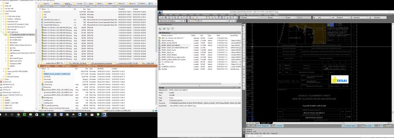

Please see the image attached, i have CAD opened in my main screen and in the other screen i have several explorer opened with several dwg's that i need to open up directly, as I keep under control the project and it's just easier and faster.
I can't each time open the dwg that i want by navigating through the infinite subfolders from CAD... it's just too inefficient.
It's unbelievable that one should open up a dwg only from within CAD if he wants to open it up with his default workspace

I add all the folders my projects are stored in to the AutoCAD Open dialog box to make getting to drawing files a snap. My Application Menu number of recently-used files is set to 50 for quick access to the last 50 drawings opened with AutoCAD so that would be useless to you as well. Hard to imagine a more efficient way of opening drawings.

I had this problem for quite some time with version 2014 and got frustrated every time I had to wait for everything to boot up on a workspace I did not like, and then have to wait again when I switched to my personal workspace. I tried everything in WSSETTINGS and even the supposed trick to add /w"" to the end of the Target source in the desktop icon... but nothing worked. I resided to the fact that I would just have to select my workspace every time... that is until I discovered a little icon sitting right in plain sight next to the workspace drop down list...
it is the My Workspace command (WSCURRENT to be exact), and it sets the current workspace you are on as your default workspace... and I tested it by shutting down and starting up again and again just to make sure it would work... I actually stood up and pumped my fist after I tried it! Hope this solves your problem as well!
