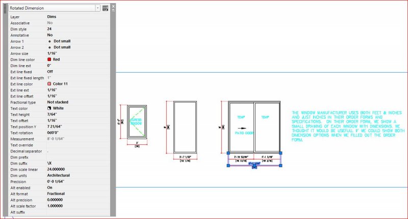

I am currently using AutoCad LT 2013. I am also using the AutoCad Classic workspace setting. My problem is the Alternate dimension scale factor. Currently my “DIMALTF” is set at 1. In my Dimension Style Manager, the Multiplier for alt units: is set at 1. Despite these 2 settings, whenever I dimension something, the alternate dimension has been multiplied by 24.5. When I check the properties of that dimension, the Alt scale factor is 24.5. How can I get the alternate dimensions to have the correct (1) scale factor?

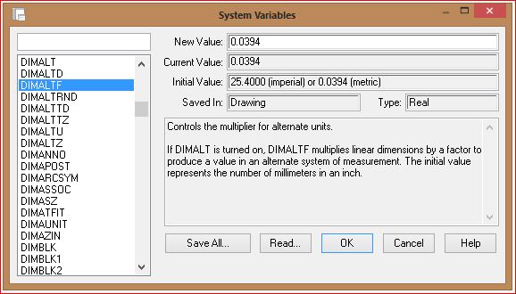

The default DIMALTF values, are those shown in the second screenshot, 25.4 for Imperial units, and 0.0394 for Metric, not 1.
It sounds to me, upon rereading your post, that all you will need to do is change the DIMALTF to 0.0394, or if you want it more accurate still, use the value I show in the screenshot.

I changed the DIMALTF setting and the Alt scale factor to .03937 with no affect. I've attached a simple drawing file showing what I'm trying to do.

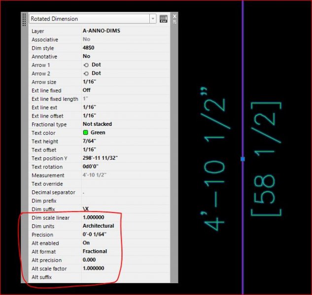

Look at the screenshot, and you will see a number of the relevant settings, in my Quick Properties display.
Since they are both meant to display Imperial units (albeit slightly differently), rather than convert to Metric, your DIMALTF should be 1.
If you do that within the Modify command in the Dimstyle Manager, you don't need to manually adjust the system variable.
They are one and the same, they just put that option in the DimStyle Manager dialog to spare those intrepid souls, who would be wary of going into their system variables directly.

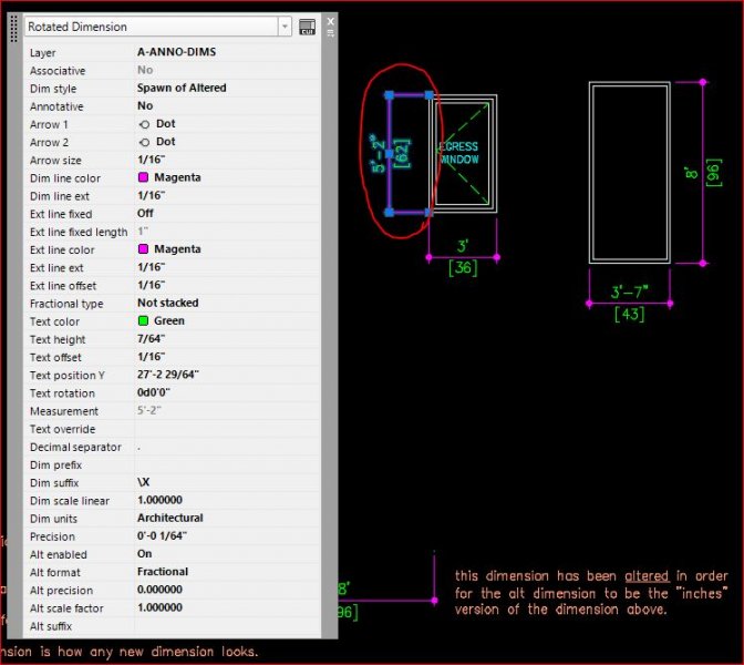

I did these dimensions in Paperspace.
I took some liberties with the colors, and used the Small Dot, instead of the BIG ONE, as I found it a bit much. :|

Dimension Issues.dwgFor this project, I'm trying to keep it as easy and simple as possible. The easier it is, the less time it will take to get the job done. For this drawing, I don't want to use Paperspace. From modelspace we will make PDF's and send them to the window manufacturer. All I want to do is set whatever variables are needed, so when anyone puts in new dimensions, they don't have to edit the dimensions to get the Alternative dimensions to be the "inches" version of the dimension above.
Note: I have changed the dimension variables to everything that has been suggested, but whenever I change the variables, I see no change to the dimensions.

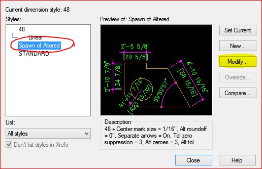

I opened your new drawing, selected one of the dimensions which you had altered, in the lower left corner, then in my Right Click Shortcut menu, I chose the Dimension Style / Save as a new style option.
After you do that, you will need to specify the name that you want to give it.
So in the drawing I have attached, there is a NEW dimstyle named Spawn of Altered (suitable for renaming).
It contains all of the modifications which you had done to that one previously.
I then did a crossing window selection of all the windows up at the top, chose Dimensions, then changed the dimstyle of all of those, to that strangely named new dimstyle.
I hope that helps you. :)
When you alter the variables for a single, or even multiple selected dimensions, it is done on those dimensions only. In order to see changes reflected across the board, on all of the dimensions in your drawing using that Dimstyle, you need to make the changes in the DIMSTYLE MANAGER, and start by selecting the dimstyle in the dropdown list, then MODIFY, from the right hand list. When finished you need to OK the modifications, to confirm that you want to at the bottom of the dialog box. Then Close the Dimstyle Manager, and any dimensions in your drawing using that dimstyle will update to reflect the dimstyle changes you have made and SAVED. Which is why, after creating the new dimstyle, I needed to change the dimstyles of all those I wanted affected, to that Dimstyle, so they would change. In order to change the name of Spawn of Altered, go into the Dimstyle Manager dialog, and right click on the dimstyle name, and use the Rename option.

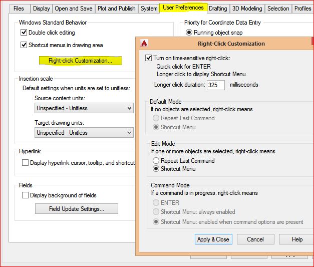

If you rarely use your Right Click Shortcut menu, you might want to try using it more, as there are often some very useful functions available there, dealing specifically with whatever type of entity is currently selected, or if there are mid command options.
I am a HUGE fan of Time Sensitive Right Click, as shown in the screenshot.
