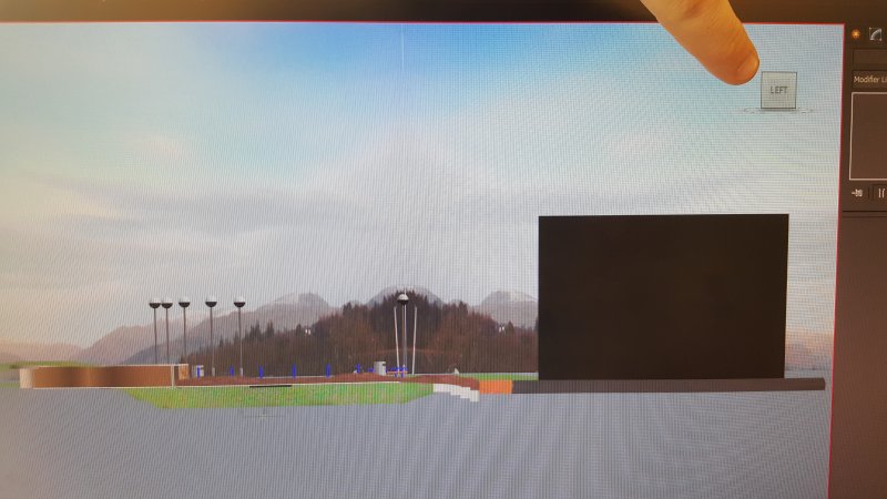

MillerMG Posted April 7, 2016 Author Share Posted April 7, 2016 Here is one image I took of the work I am messing up on. Quote Link to comment Share on other sites More sharing options...

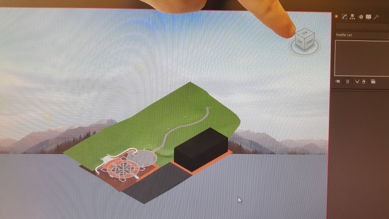

MillerMG Posted April 7, 2016 Author Share Posted April 7, 2016 This is the ortho view after rotating the viewport Quote Link to comment Share on other sites More sharing options...
Cad64 Posted April 7, 2016 Share Posted April 7, 2016 When you're setting up a project for rendering, you don't want to be in an orthographic view. You need to be in Perspective view. This will make everything look more realistic. As for background images, I always add them in Photoshop after rendering. This gives me the freedom to try out different images in case I decide that I don't like the image I used in the render, which happens all the time. I can also easily apply effects to the background and add more elements like trees, buildings, etc. without having to do a lot of image editing or re-rendering. By the way, what version of Studio Max are you using? 2016? Quote Link to comment Share on other sites More sharing options...
MillerMG Posted April 7, 2016 Author Share Posted April 7, 2016 Thanks CAD64. I am using 2016. Is it not possible for the background to move with the viewport? Is it locked in that one location? Thank you very much for the ortho vs. perspective views! Quote Link to comment Share on other sites More sharing options...
Cad64 Posted April 7, 2016 Share Posted April 7, 2016 If you followed that tutorial then yes, it's locked to the background. You don't want it to move when you orbit around the model though. The background image needs to be facing the camera for rendering. The idea is for the background image to be fixed in place any then you pan/zoom/orbit your model around until it fits the background image. But, if you want the background to move with the model when you orbit around you will need to create a flat plane behind your model, with the same aspect ratio as your image, and then apply the image to the plane. Here's a little tutorial. It shows you how to set up a planes for reference images, but it's the same idea for setting up a background image on a plane: http://blog.digitaltutors.com/setup-reference-images-easily-3ds-max/ Quote Link to comment Share on other sites More sharing options...
