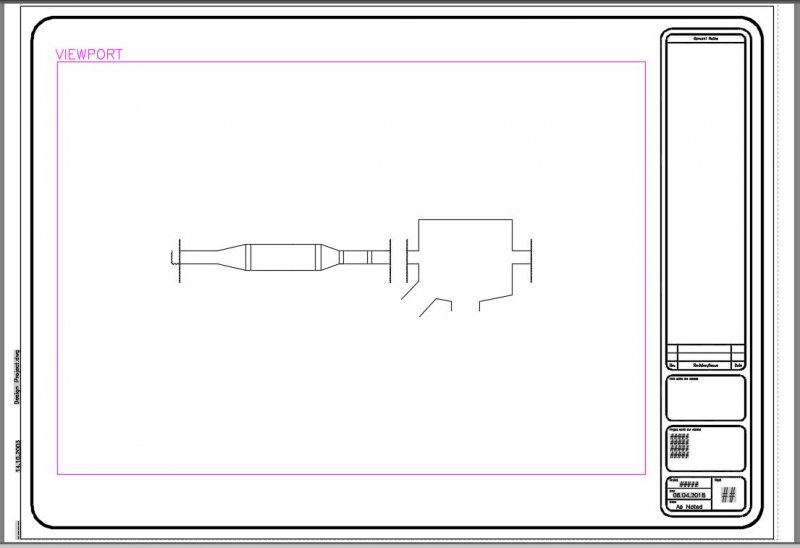

sakonpure6 Posted April 6, 2016 Author Posted April 6, 2016 Hey Remark, This time, I created the drawing all in meters using the Civil Metric sheet template provided by the software. I plan to add in hatches and measurements on the ISO A1 sheet, but for some reason, my model is not showing up there. Here is what I have, what do you think? Design Project.dwg Quote

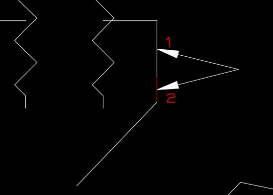

ReMark Posted April 6, 2016 Posted April 6, 2016 (edited) Unless you have at least one viewport in your layout you won't see anything you have created back in model space. I do believe I mentioned that previously. Create a new layer for your viewports (ex. - VPorts), assign the color magenta to the layer, and set the layer to "no print". While in your layout start the MView command to create a viewport. Start with a single viewport. Do yourself a favor and leave the color of layer "0" white and don't draw anything that isn't going to ultimately be a block on this layer. Create a new layer called Geometry and assign it the color white. Move all your linework to this layer. Color should be "ByLayer" rather than "ByBlock" whenever feasible. Don't draw multiple straight line segments when a single line will suffice. You are just making more work for yourself. Refer to image below. You have two separate lines where a single line would work just as well. There are other parts of your drawing where you do the same thing. Have you gone through the tutorials here at CADTutor? Edited April 6, 2016 by ReMark Quote
ReMark Posted April 6, 2016 Posted April 6, 2016 Viewport example. The viewport scale is 10:1. Some information I put together about viewports can be found here...http://www.cadtutor.net/forum/showthread.php?72972-Things-you-should-know-about-Viewports.&highlight=viewport+scale Different ways to set the scale of a viewport are mentioned here...http://www.cadtutor.net/forum/showthread.php?72213-Viewports-and-Setting-Scale&highlight=viewports Both of the above links reference viewports used in a layout. There are also modelspace viewports which are slightly different. Quote
