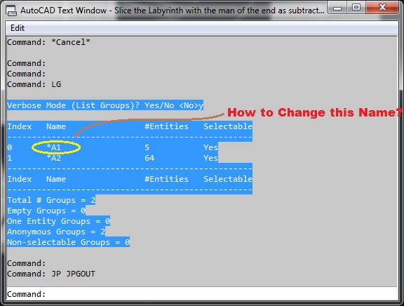

Deby Ferdian Posted March 31, 2016 Posted March 31, 2016 (edited) I got the LISP Routine from @Herman Mayfarth it's "purgegroup.lsp" to create a Group List and their Groups Names and prompted them to the Text Window screen is appear.. But my wish is How could be if I want to change their name of group name are listed by random ? Here it is, will let you see be clearly.. Edited March 31, 2016 by Deby Ferdian Quote

SLW210 Posted March 31, 2016 Posted March 31, 2016 Those are anonymous groups. I do believe they can not be renamed. Might could do something with them through LISP. Here is a LISP to delete them. http://www.cadforum.cz/cadforum_en/how-to-remove-all-anonymous-groups-from-an-autocad-drawing-tip9324 Quote
