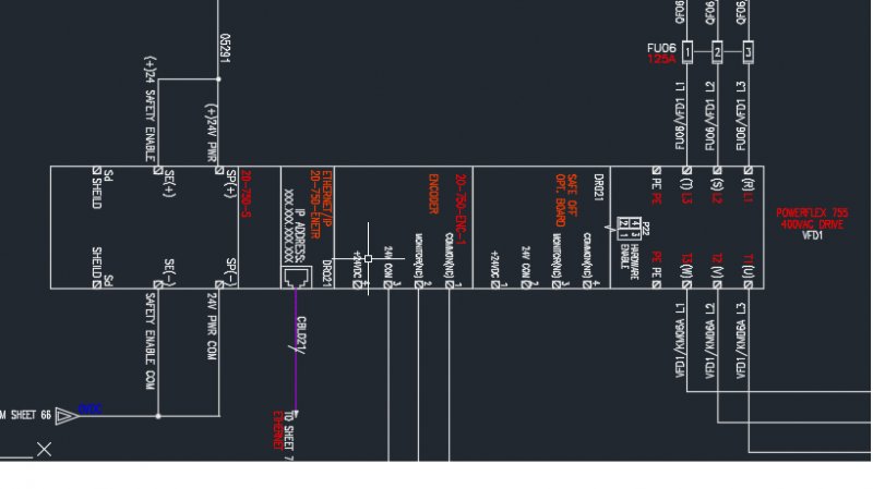

ENG_OBAIDULLAH Posted March 30, 2016 Posted March 30, 2016 Good day; I'm working in CAD electrical and have 2 problems 1. trying to get blocks for VFD IO; same like attached photo; can anyone help from where to get this blocks. 2. I've created a project file contains several CAD sheets; while publish to PDF file; the plotting area is not uniform for all sheets; and not able to set the plot area for full project; I need a support how to publish plot area - for example "extent" - to all project sheets. thanks in advance Quote

ENG_OBAIDULLAH Posted March 30, 2016 Author Posted March 30, 2016 I Tried with Rockwell but all available DWG are dimensional not IO; I believed that those blocks might be included in schematic polt area; yes I'm plotting from model Quote

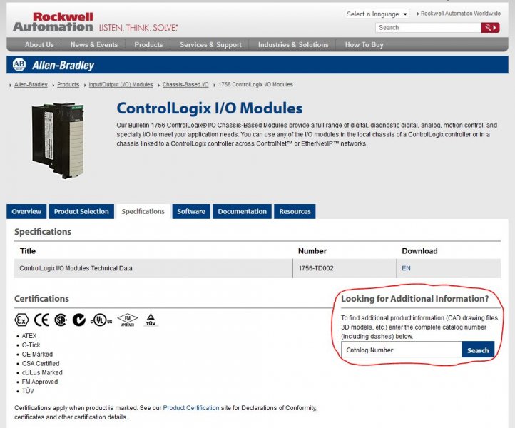

ReMark Posted March 31, 2016 Posted March 31, 2016 The only thing I could find other than drawings of the actual components (Powerflex 755 and Softstarter). Quote
welldriller Posted April 5, 2016 Posted April 5, 2016 (edited) Have you looked at this site. Has downloadable cad blocks http://ecatalog.weg.net/drawings_2d_3d/index.asp?empresa=WA&language=EN&cm=CONTROLS http://www.weg.net/us/Products-Services/Controls/Terminal-Blocks/Terminal-Blocks Edited April 5, 2016 by welldriller found more Quote
