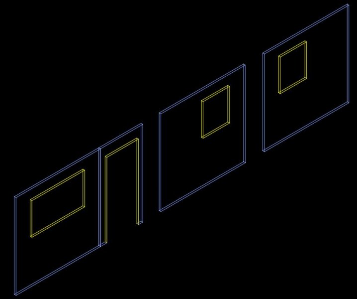

JimB Posted March 30, 2016 Author Posted March 30, 2016 The attached is an extract from the drw I can isolate and edit using the control key highlighting lines (which has to be all of them and them move to left or right if I want ... but is there an easier way of simply highlighting the entire subtracted model and doing the same just to move left or right or even possibly enlarg ? extract.dwg Quote
JimB Posted March 30, 2016 Author Posted March 30, 2016 Example with the window opening or door Quote
ReMark Posted March 30, 2016 Posted March 30, 2016 Example with the window opening or door What exactly do you want to do? Reposition the door or window or change the size of one or another or what? Quote
JimB Posted March 30, 2016 Author Posted March 30, 2016 Yer both .. I do that sort of thing often Quote
ReMark Posted March 30, 2016 Posted March 30, 2016 Resized window then moved window to new position. Done using the Move Faces command. Just be careful with your picks and remember to remove faces from the selection set you do not want to edit. Quote

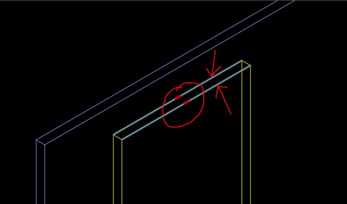

ReMark Posted March 30, 2016 Posted March 30, 2016 OK...just thought of something. Have you tried holding down the CTRL key when you make your picks? Note the red grips and highlighted edges. Quote
JimB Posted March 30, 2016 Author Posted March 30, 2016 Yep thats the way I'm doing tonight ... and thats whats frustrating me Mark becasue I'm positive their was relatively simple process of just identifing the subtracted object and editing as normal ... then escaping with changes made. But just cant remember it. As Im typing I'm thinking it may have been utilising the isolate tool but can twork out how I did it ... appreciate your time on this ... leave it wiht me Mark if I work it out I'll post it here . Thanks a lot guys Quote
