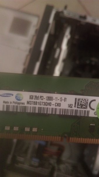

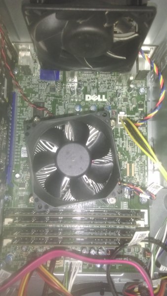

kulfi Posted March 30, 2016 Author Posted March 30, 2016 (edited) Handiman said: I have some questions about your system, when you can. I am getting ready to start with Revit and I need to spec 2 work stations for us.From what I have researched so far your system looks good. I feel like the GTX-750 Ti might be on the lower end, I would like to have 4GB-6GB of video memory on the card, GTX-760 w/4GB is $340 and GTX-960 w/4GB are $250+. My question is what is your So I can look at it's speed and latency. Also what motherboard is the system built on? One thing I keep seeing when reading about others systems is to match the motherboard and memory and then be sure a lot of the little items all work with each other. Like # of memory channels, PCI card slots and the version and lanes. SSD and now the newest PCIe 3.0 M 2 slot for SSD. Possibly use a lower end card but use 2 or 3 for the processing power in the GPU's. When you get some time I would like to know the memory model and motherboard maker/model #. Thanks in advance for your time. Randy Thanks for the Reply I will be adding some more informations. a. how large (file size), complicated (detail), clean (model best practice) is the linked Arch. file? Yes i have purged the model, Removed the link for Arch Model. the Size of the file 40 MB only. b. what have you got modeled in your file? What did you do to "half" its size? It is MEP Model with Pipes and Pipes Accessories, and for instance if i delete three or four floors than the model size is reduced and the performance is better c. It takes times to Load in opening time, it takes time to draw or edit a pipe in all operations it is slow and we have central file and even on synchronizing it takes time. d. we have four memory slots each 8 GB. e. We are using Optiplex 9020 Tower banded computer from Dell. Edited March 30, 2016 by kulfi Some More Informations to be Added Quote

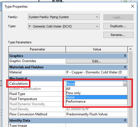

glenbob305 Posted March 31, 2016 Posted March 31, 2016 Is this your first time installing/using any version of revit? Is it just 2016? I run 2014 and 2015 on an older higher end desktop system with lower specs than what you're talking about. It should be able to work in 2d views without much speed problems. 3d views shouldn't be that bad either. Revit is kind of slow always, but it'd hard to say whether what your seeing is atypical Quote
tzframpton Posted March 31, 2016 Posted March 31, 2016 kulfi said: If it does not have any performance issue while all revit operations than pls can you tell the specifications you are using for the software and the hardware.thanks I can't think of anything else that could be causing such things. Again I'm using almost identical specs. My video card is a little better than yours but that shouldn't affect performance in this manner. One other thing to see is if your pipes are calculating flow. Select the Pipe System and in Type Properties, see what setting it's on. I set mine to "None" which can be very helpful with a huge model such as yours. Quote
