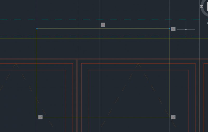

I don't know what I did, but somehow these annoying icons keep showing show up at each corner of the object when I select an object. Does anyone know how to turn it off? I have been spending hours to figure out how to online, but failed....
Menu ---> Parametric ---> Constraint Bars ---> Hide All
Thank you guys! I can now finish my drawings in time!!!! Thank you again!
