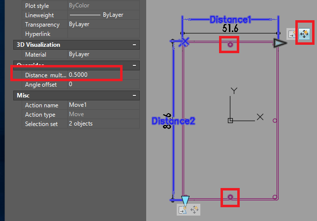

You had the right idea, just the wrong Action. Instead of stretch, I simply used the Move Action, but decreased the multiplier to 0.5 since it's mathematically half the distance of the first and second points on the Distance parameter. Seems to be working just fine now.
