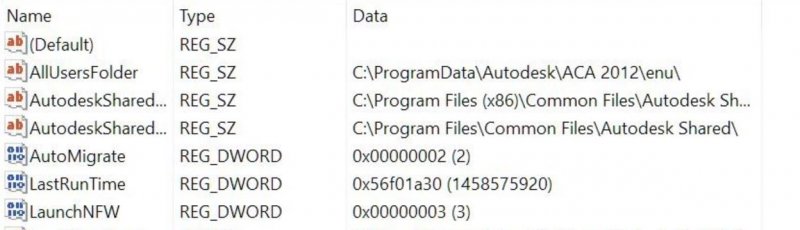

MDD73 Posted March 21, 2016 Author Posted March 21, 2016 I backed up the registry and also did a system backup. Checked the registry and entry LaunchNFW was showing a (3) which I guess would solve the problem but it didn't. Registry location is: HKEY_CURRENT_USER\Software\Autodesk\AutoCAD\R18.2\ACAD-A001:409 and when LaunchNFW is 1 Autodesk Exchange will auto-start. When the LaunchNFW is 3 Autodesk Exchange will not show when AutoCAD starts. I will probably have to persevere with what I have. Thank you for your help. Quote
ReMark Posted March 21, 2016 Posted March 21, 2016 And you did a reboot AFTER editing the Registry? Quote
