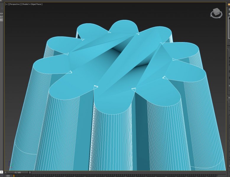

nerys Posted March 18, 2016 Posted March 18, 2016 I am making rocket components with my 3d Printer. one project is to make interesting 3d SKINS to built a rocket out of that would be pretty hard to impossible to easily do without 3d printing. anyway. I am starting simple. star shape. Here is what I have done. Star Shape. Adjust Extrude Taper convert to editable poly shell Shell is a new one printer had problems till I realized I was wrapping a 2d plane into 3d space and that was ticking off the slicer. adding shell "made it" a 3d shape and make the edge more nozzle compatible as well. so I made a tube nose cone and fin can. all is well except the nose cone. will not print usable (thin and unstable) I realize I don't need the nose cone to be hollow as only its exterior dimensions are important not its interior dimensions the problem I am having is its coming out too thin and the tricks to thicken the body tube don't work on the nose cone for some reason. if I made it solid I gain several advantages. for starters far far fewer polygons so my slicer won't puke its guts up trying to slice it. Second I can tell it to make it hollow with 2 outer layers. ie get my thicker walls that I need. I tried removing the shell modifier that will make it a solid part again but this changes the "shape" of the object and that is really bad since it won't match the outline of the other objects. no adjusting of the outline seems to have the needed effect it works but I can not get the same shape. its always "off" by enough that it won't line up with the other parts (mostly the tips of the star points too skinny and I can't fatten them up.) if I could just retain my shape with shell and gut the inside and make it solid that should work but I can not figure out how to do that. suggestions? Here is the file https://drive.google.com/file/d/0B-XVTPUBrxzwUWxPZTR5Q29DQ00/view?usp=sharing Quote
Cad64 Posted March 18, 2016 Posted March 18, 2016 One thing I see right off the bat is that you have a ton of overlapping and interpenetrating geometry. Take a look at the screenshot below. See where the geometry is criss-crossing and protruding through the top? This is probably why you're having problems trying to print. I would recommend cleaning up the model and see if you have better luck. As for removing the Shell modifier without changing the shape, don't delete it. Right click on it and choose "Collapse To". This will collapse all the modifiers in the stack and leave you with an Editable Mesh which you can then convert to Editable Poly. From there you will be able to clean up the model to get rid of all the overlapping geometry. Quote

nerys Posted March 18, 2016 Author Posted March 18, 2016 OK I ran the commands you suggested. still had no idea what you meant by "clean up" after that however I did however run the STL through the microsoft service to clean up 3d files on azura that seems to have the desired effect to a point. the file is now half the size it was 2.48mb instead of 5mb AND it shows up as solid in maker desktop!! so I can use infill and shells and the resulting print is SO much better. maker desktop still throws a fit slicing it however. I had to use .3mm layer height to get it to even chunk it without puking on it. it did work however. splendidly. I wish we could tell these machines to never move the nozzle over a "void" area. ie always take the long path that keeps the nozzle over plastic no matter what (unless void is the only way) that would eliminate "stringies" though I only had very minor stringing on this one!! I will post pics and files later so you can see what it did and if that is what you meant! for now must get my butt moving for work! Quote
Cad64 Posted March 18, 2016 Posted March 18, 2016 What I mean by "clean up" is to manually fix all the overlapping and interpenetrating geometry so that the models topology is clean and uniform and the model is watertight. It gets really messy towards the top of the model and would require quite a bit of work to clean it up. It sounds like you were able to fix it and get it printed though. Quote

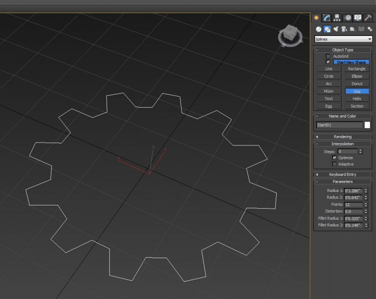

nerys Posted March 18, 2016 Author Posted March 18, 2016 Awesome. Thankyou. One more question. I have been pulling my hair out trying to figure this one out How do i make this shape. I know how to extrude and twist it etc.. but i cant find the original shape to start with http://www.thingiverse.com/thing:38948 How do i make a square tooth gear like star like that? Quote
Cad64 Posted March 18, 2016 Posted March 18, 2016 I think you may have to keep pulling your hair out. That doesn't look like a very simple object to create. There is a lot of blending of shapes at the base and the tip where the fins begin and end. If you want to attempt it and begin with a gear shape, go to the "Splines" panel and select the "Star" shape. Under "Interpolation", set the number of steps to 0, then adjust your radius values and fillet radius values to get the gear shape you like. Quote
nerys Posted March 19, 2016 Author Posted March 19, 2016 Ahh thats it exactly. I am not trying to duplicate his design only that profile right there! Thank you! Quote
nerys Posted March 19, 2016 Author Posted March 19, 2016 I tried to follow your instructiins but it does not seem to work I could not find splines. Star is located under shapes for me so i used that. I opened interpolation and set steps to 0 but nothing happens remains a star. Never mind spoke too soon seems i have to really change fillet to see the effect. Got it! Thank you so much! Quote
