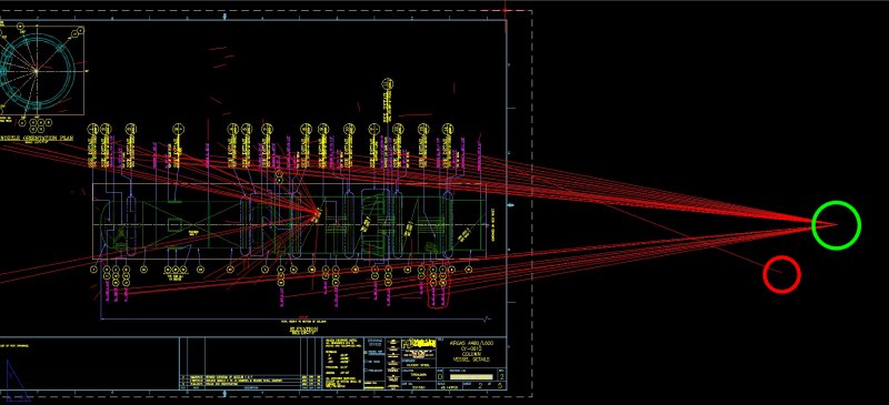

yes, the code drew lines appropriately and then some. I took out the alert and did something else which stopped the 'then some' lines from being drawn.
However, I'm getting a foreach syntax error without the ;
As of right now, this is the current code and this screen shot is from a freshly opened drawing as 'ready only' with a single ordinate dimension moved away from the datum used for the others.

The Green Circle indicates ordinate dimensions that have the correct datum, as this was the User Origin from the input. This was the comparison point.
The Red Circle indicates the ordinate dimension that I moved to show an incorrect datum. The lisp should be drawing only to this incorrect ordinate dimension with a single red line. If the image comes out clear enough, you can see multiple extra lines throughout the drawing- I don't want them in there. Its definitely progress.

It looks like this image is from paper space - is that right? I haven't tested for the ordinate datum being outside the viewport. Don't suppose you can strip the border and post the drawing?
Yes, it's from paperspace. I have my autocad setup that way so I can see all but the darkest of colors. I tested the lisp outside the viewport and it works fine, that's what the result is. It translates well enough. And I can't exactly strip the drawing for a few reasons. The pieces are referenced and are big. two, I don't know how comfortable the company would be with me adding in the objects. The most I think I could provide would be unintelligent, general objects and even that I'd like to get permission for. However, I won't be able to ask for that until

If you want to try this, I've changed the code a little to try to put an ellipse around the dimensions instead of drawing a line to it. Just a thought...
Let us know how your tinkering turns out!

When I run your code with the ellipse, it comes out with a "error: bad dxf group: (11)"
I'll post a fix if I find one.
