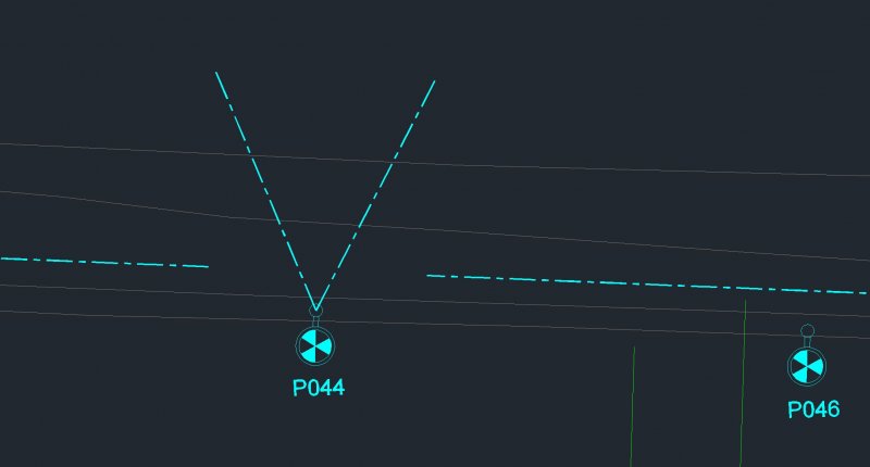

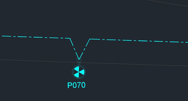

attachment.php?attachmentid=57299&cid=1&stc=1 correct way
attachment.php?attachmentid=57300&cid=1&stc=1 Incorrect way
I have used this lsp command above (noob post!!) for years and only today has it started acting weird.. Sometimes it works, Sometimes it doesnt.. Same drawing,Same layers, Same linetypes..
Typing 'lilo' normally asks you to select your lighting column (blue symbols) then the Cable type (blue polyline) and it splits the polyline adding a neat split arrow between, simulating an underground cable on a highway lighting installation..
All help warmly received,
Thanks
I am a typical CAD user and mainly draw electrical lighting designs on other peoples road or highway layouts. Often I Insert a block consisting only of 2 normal circles to represent a lighting column then draw a polyline behind each of the lighting columns. then using a lsp command (used in my department for years, which we have no idea who created it).. I click on each lighting column then click on the polyline(cable) and the routine adds in break into the cable and joins up to the centre of the lighting column.
Today its started to do weird things.. Sometimes it works, then it doesnt..
Same linetype, same layer, same way of doing it... Diff result?
tested on Acad 2014, 2015 and 2016...
A couple of things is line in 3d ie Z not zero each end, are you in a different UCS than Line ?
