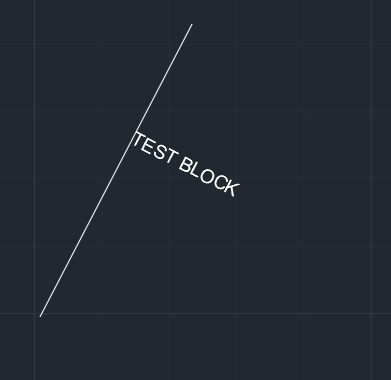

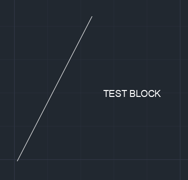

mrigorh Posted January 6, 2021 Share Posted January 6, 2021 Hey! The lisp is working pretty fine. Now I'm trying a new function inside that same lisp. There is a way to define a offset from the line to move the block? Example: https://ibb.co/hLt77cZ <- inicial sutiation https://ibb.co/z5rWJ24 <- LISP works untill here https://ibb.co/g6tJknT <- this is what a need to be done Quote Link to comment Share on other sites More sharing options...
BIGAL Posted January 6, 2021 Share Posted January 6, 2021 In the code there is pt and this_is_the_point so you can use the polar function to reset this_is_the_point at an offset just do it 1 line above the vla-move you have an angle of the two points. Have a go, good to learn we are here to help if you get stuck. Quote Link to comment Share on other sites More sharing options...

mrigorh Posted March 17, 2021 Share Posted March 17, 2021 On 1/6/2021 at 8:37 PM, BIGAL said: In the code there is pt and this_is_the_point so you can use the polar function to reset this_is_the_point at an offset just do it 1 line above the vla-move you have an angle of the two points. Have a go, good to learn we are here to help if you get stuck. Hey BIGAL, thanks for your help. I get stuck in how to put this comand line of polar function as you mentioned. I need a very simple offset at a distance of 1. I'm doing it at excel, but it takes a long work. I've tried this line but didn't work (+ (polar (this_is_the_point) (pt)) (1)) (vla-move ptobj (vlax-3d-point pt) (vlax-3d-point this_is_the_point)) (vla-Rotate ptobj (vlax-3d-point this_is_the_point) (angle pt this_is_the_point)) Quote Link to comment Share on other sites More sharing options...
BIGAL Posted March 17, 2021 Share Posted March 17, 2021 Try (setq this_is_the _point (polar this_is_the_point (angle pt this_is _the_point ) 1)) Quote Link to comment Share on other sites More sharing options...
mrigorh Posted March 18, 2021 Share Posted March 18, 2021 17 hours ago, BIGAL said: Try (setq this_is_the _point (polar this_is_the_point (angle pt this_is _the_point ) 1)) Yes, that worked really well. Thanks! Quote Link to comment Share on other sites More sharing options...
