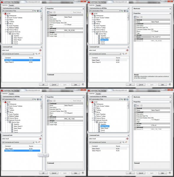

Deby Ferdian Posted March 14, 2016 Author Share Posted March 14, 2016 YES.. It just happen because of you.. Thank you so much @tombu! it turns out all this time I just do not know how it works! You are my hero! and friends the other... But how to insert or given an aliases command as what I've try on the attach file that I give an above to looking for the solution before these.. I was try assigned "EW & WQ" as a "'result & 'result;0". What do you say ? Quote Link to comment Share on other sites More sharing options...
tombu Posted March 14, 2016 Share Posted March 14, 2016 I'm not sure getting any transparent command to work using an aliases the way you want is possible. You can add it to the CUI though. One of 13 Macros in Select menu from my CUIX file: Name = Added by Previous Commands Macro = 'Result You've got me thinking about the routine though. When I get time I'm going to try replacing the prompt with a getkword to give me the option to use my mouse. I'll reply here if I do. Quote Link to comment Share on other sites More sharing options...
Deby Ferdian Posted March 14, 2016 Author Share Posted March 14, 2016 (edited) Yeah..! and I am sorry it's my mistake. I think so mean same as you are though too.. Yes, the onto CUIX I mean exactly right! and I assigned the combine keys too likes; "CTRL+SHIFT+F as a 'Result" and "CTRL+R as a 'Result;0" Oke, @tombu! thank you for your appreciation and have give hard attention to me. Hehe..! ^_^" Thx again and I'll be wait.. Edited March 14, 2016 by Deby Ferdian Answer for waitting! Quote Link to comment Share on other sites More sharing options...
Deby Ferdian Posted March 15, 2016 Author Share Posted March 15, 2016 Now.. I got it. I did! because I have been sucessfully to create it into CUI but there is a one problem I have now. Could it these do with "SELECT" directly than it after a link of history selections are seen in an one action to process together by CUI and/or "'result" of command line ??? Quote Link to comment Share on other sites More sharing options...
