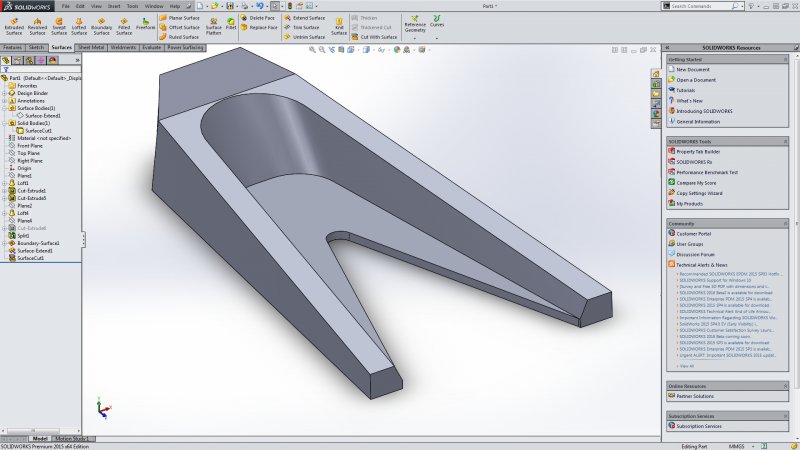

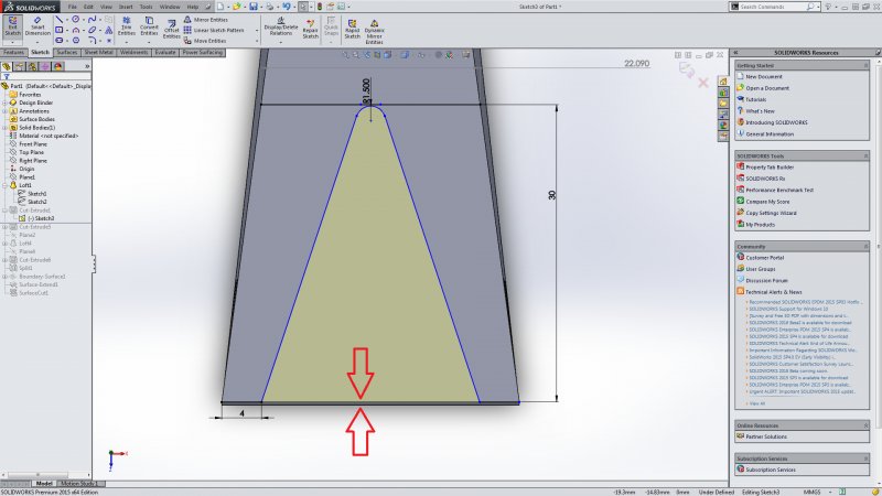

endlasuresh Posted March 27, 2016 Author Share Posted March 27, 2016 I am attaching the current file just need to cut from the top sketch to down sketch ith slope. you can see the first image which i posted. http://s000.tinyupload.com/index.php?file_id=07548010129432312442 I want to cut the light sketch from top to bottom sketch with some slope. I tried loft method, but it needs some distance between these two sketches. Quote Link to comment Share on other sites More sharing options...
shift1313 Posted March 28, 2016 Share Posted March 28, 2016 Suresh, i got your file open and first note for you. Cut-Extrude6 is producing bad geometry. There is no way you are going to machine that.If you are trying to cut away that little sliver made by one of your other cuts use the "Split" tool. You can select the 4 inside faces as the trim tools then split the body. Note 2, sketch 18 is under defined. make sure you have Tangency between your Arc and lins. Also you have a close profile and then 2 extra lines. If you are trying to make a Loft-Cut make sure you make a nice profile with no extra data. You can convert a few lines to construction if you need them in there as reference. Blue lines = under defined. Note 3, your arc of sketch 18 went under geometry so if you tried to use it as a loft cut profile it would leave some solid geometry there. Note 4, a loft cut between these shapes is less than ideal. When you do something like this(loft, boundary etc) you want to make sure that each profile has the same number of sketch entities if possible. if not your shape will be compromised in nearly every case. Because the "base" of your loft cut would have two arcs and a straight line, but the top(sketch 18 ) has just an arc, the loft between these gets messy. If you use a Boundary Cut instead of a Loft Cut you have control over the little green dot that lines up each profile. In a loft it has to be at the start/end of a segment. Because your sketch will end up leaving another small sliver i opted to make a boundary surface so i could extend it. Then i used the operation "Cut With Surface" to remove. You could also draw a profile on the end of your part and sweep Sketch 18 and the base as a path. As it is this thing is going to be slightly painful to machine. The outside at the small end are perpendicular but closer to the top of your image are 82.xx degrees. So this can't be easily done with a normal End Mill or a tapered bit. I would suggest picking a taper on the outside to match a bit you have if that geometry is important to you. Also the cut i just did will require a lot of parallel passes with a ball end mill to cut so make sure you match the fillet at the bottom to whatever tool you are going to use(preferably a little larger). Quote Link to comment Share on other sites More sharing options...
endlasuresh Posted March 28, 2016 Author Share Posted March 28, 2016 Hi thanks again, really looks very beautiful. Yes there were so many mistakes in that file, I tried to cut the part through all Extrude cut1, but it left a 0.03 mm of it, can you specify why it wasn't allowing me to cut whole. Yes the geometry gone bad, but was looking to finish it. I want this to be cut in the extrude cut1, tried even by zooming the area to see if there are any free space. I will check other things too. Quote Link to comment Share on other sites More sharing options...
shift1313 Posted March 28, 2016 Share Posted March 28, 2016 From the beginning suresh make sure that your sketches are fully defined. This means all relations and dimensions to make sure they don't move. Your very first sketch that everything is based on has no dimensions or relations to keep it in place. You should make the lower line have a midpoint relations with the origin. Add angles to the sides and a total height. You can right click on a line and select its midpoint. Make sure the upper lines midpoint is vertical with the origin to keep it all symmetric. The lines were exact lengths so im guessing you used the Additional Parameters section in the line properties. This doesn't add any dimensions to the line and is really not a good way to do things because they do remain undefined. With sketch 2 it was fully defined so that is good! You can simplify things on the lower line by adding a midpoint relation with the origin rather than two 15mm dimensions to keep it centered. Cut-Extrude1. This sketch was under defined again. You have some small 4mm lines that don't need to be there. The reason this cut leaves a bit is because the face you are sketching on is not normal to the end of your part. So you are extruding down but if you look at the sketch "Normal To" you can see. The attached image show this. You need to extend your sketch at least to the lower line of the area you want to cut out or completely past the body. Or you can use other tools like "Split" or cut with surface or something. Cut-Extrude5, this sketch(sketch6) is fully defined but needs to terminate at a different point. What i would do is either make these surfaces and extend them to use the Cut with Surface tool, or make a 1mm offset plane from the bottom(where you are extruding to) and then find out where it intersects your geometry. I feel like you have a lot of angles on the part that aren't needed for the design since you are CNCing the part. With molded plastic parts it is very important to have certain geometry for strength. Keeping a consistent wall thickness and getting strong parts with the tools you have to design with makes it a challenge. With CNC you aren't constrained to the same design criteria. If you are trying to reverse engineer something thats fine but there is no need to have tapered walls/draft on a part like this you are going to mill. i would make it easier on yourself. Quote Link to comment Share on other sites More sharing options...
endlasuresh Posted March 29, 2016 Author Share Posted March 29, 2016 Thanks a lot, I was gone through your steps as per the sketch1, I have made the sketch through dimension, but removed the half lines and made a single line at this stage they were not defined. Thanks for it and I never knew the right click for mid point and there were a lot of tools in the right click. I found the sketch is not touching the boundary line in extrudecut1 of backside and in the last corrected through the back. Some of the sktches Ive corrected and their are lot of angels as per the sample and they designed perfectly. I am not hoping that I would get the correct shape in cnc which I am currently drawing, because they are no experienced people to do exact things I don't know about Taper will check in Google to find out and how you cut the part? I mean the second cut? I tried using Split method to cut the part, but it didn't helped in proceeding. Quote Link to comment Share on other sites More sharing options...

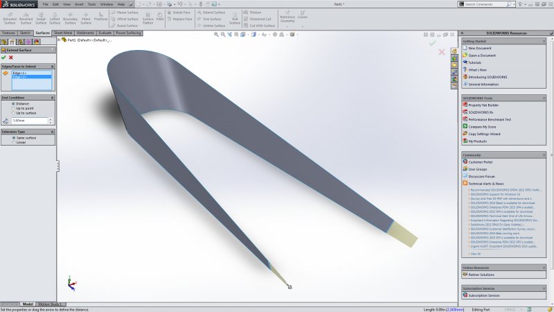

endlasuresh Posted May 22, 2016 Author Share Posted May 22, 2016 i haven't finished the last diagram even though I paid to the designer, but he neglected to do. Can you tell me how to do some cuts using extrude cut feature or some other method. 1 The first square in blue should cut with one end 6mm deep and the other end should be 2mm. 2 the square which is in slope ( white color)of the plate should cut 2 mm deep. Quote Link to comment Share on other sites More sharing options...
shift1313 Posted May 22, 2016 Share Posted May 22, 2016 Suresh for the extrude that has to go to an angle one method is to use "up to surface" boundary condition in an extrude cut. First on the side or a plane that would slice the model you want to draw a line that has the appropriate end location. Then make an extruded surface. When you do an extrude cut change the "blind" end condition to "up to surface" and select the extruded surface. On the other cut I dont know what you want it to look like. What needs to change from a simple extrude cut? Quote Link to comment Share on other sites More sharing options...
endlasuresh Posted May 28, 2016 Author Share Posted May 28, 2016 I have did finally by using mold time first time, Sorry, I was busy in the last three days with this one so unable to reply. I was asking the seond point was cutting a square or a sketch on a crossed plate. I tried using extrude method but it didnt made. Quote Link to comment Share on other sites More sharing options...
