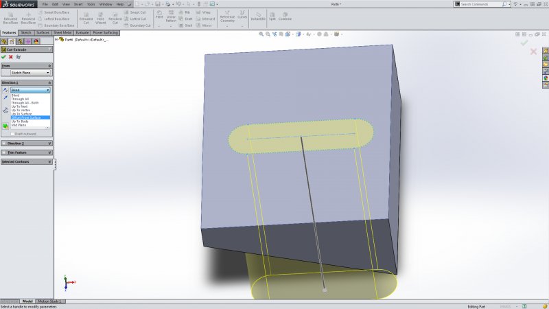

endlasuresh Posted March 24, 2016 Author Posted March 24, 2016 I have deleted the old file that was on kept drawing. It is not allowing me to cut where i want how much depth. Here is a screenshot what I meant in this square I am trying to cut from the top or bottom by leaving 3 mm thickness at the bottom, that is crosses shape. It should have thickness at the bottom what i mention. I hope you got it what I meant. Quote
shift1313 Posted March 24, 2016 Posted March 24, 2016 Did you try "shell"? It should take care of it easily. Quote
endlasuresh Posted March 25, 2016 Author Posted March 25, 2016 Yeah, tried a lot of times, but it wont allow me to select that center straight slot. Shell makes the square to cut, but not the center sketch that was drawn. Quote

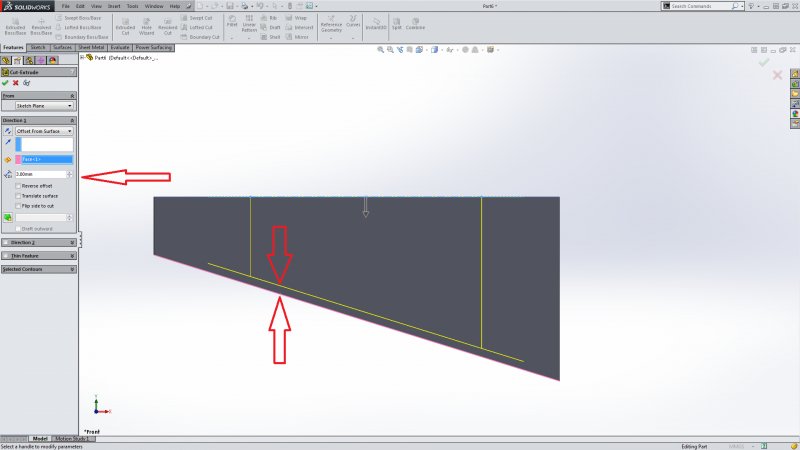

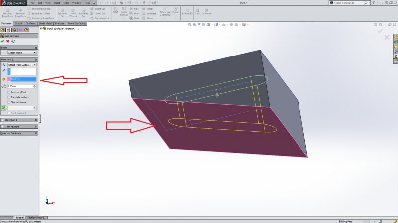

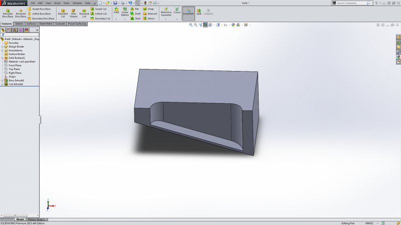

shift1313 Posted March 25, 2016 Posted March 25, 2016 Suresh, i didn't realize you only wanted to cut out the slot. In the future if you want to use shell on just a small area of the face you can use your sketch and create a "Curves>Split Line" that will let you select just a small area. To use this as an extrude you first need to select the end condition "Offset from surface" If that isn't available in your version of SW(its been around for a long time) then you will need to go to your surfaces tab and make a 3mm offset surface to extrude cut up to. After you select the end condition you will need to select the face you want to offset from. In this case the pink highlighted face. Then you can enter the distance you want to offset away from that face. In some cases you might need to check "reverse offset" depending on the direction and normal of your face. Here is a section view of what it should look like. Quote
endlasuresh Posted March 25, 2016 Author Posted March 25, 2016 Thanks, Matt It worked. I didn't used these things in extrude cut, but from this tutorial got it. Also, is there any method to cut from one slot to another slot in a slope direction.I tried using loft method and it cuts only if the two are in some sizes. An Example the top slot is width 20 and length 30mm and bottom slot is width 10mm and length 20mm, but the loft method is not allowing e to cut as it says goes in 0 or something that it cant be cutted. Quote
