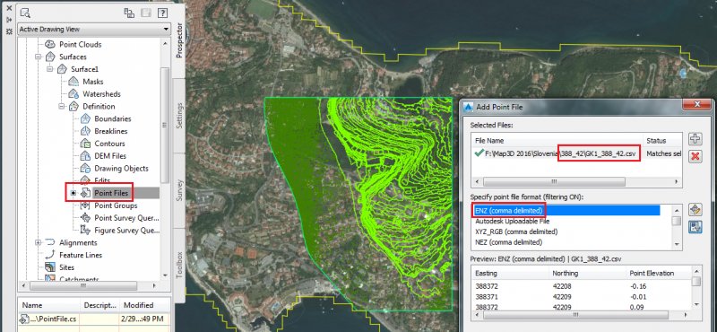

Pointdump Posted March 1, 2016 Posted March 1, 2016 Iztok, I've been working with data in the site you linked. Here is information on the different files available for download: http://evode.arso.gov.si/indexd697.html The OTR data is Ground Only Point Cloud. The GKOT data is ALL Classifications Point Cloud. (Big file) The ASCII file is a Semi-Colon Delimited Point File. I re-saved the ASCII file in Excel as a CSV file. You can then add it to your Surface Definition. As for the Projection, click on Technical Report: The data for Lidar data in D48GK projection is in: D48_Slovenia_TM WKID: 102060 Authority: ESRI OR MGI_1901_Slovene_National_Grid WKID: 3912 Authority: EPSG Please see attachment. Dave Quote

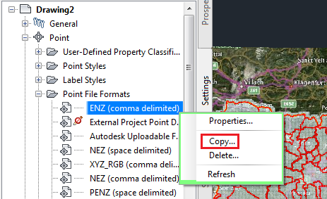

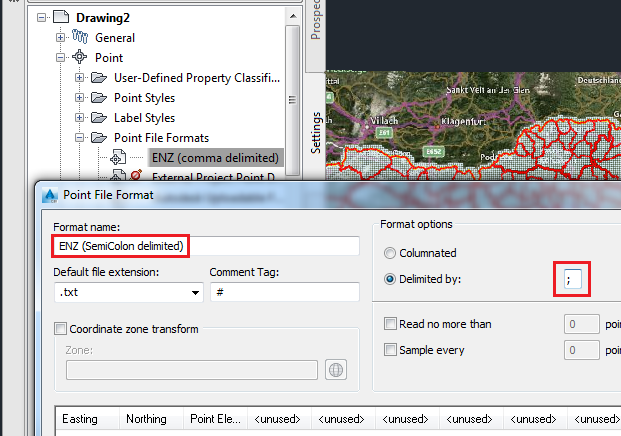

Pointdump Posted March 1, 2016 Posted March 1, 2016 Iztok, In your first attached "test.asc" file, when I opened it with Notepad I got this as a typical line: 400001;45000;44.01400002;45000;43.92400003;45000;43.79 Pretty much useless without a lot of work in Excel. I've now spent quite a bit of time on your excellent Slovenije site. When I download the ASCII file from the site, I can immediately add it to a Surface in Civil 3D by creating a SemiColon-Delimited Point File Format. Like this: Step 1. Step 2. Then you can add the ASCII file to your Surface. Dave Quote
