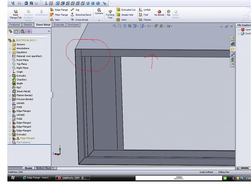

Hi iam looking for some help in sheet-metal in solidworks 2009.

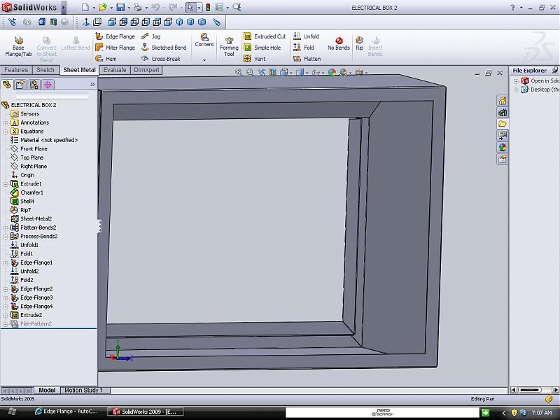

I have created this box using solid block then shell then rip so i didnt have to create all the bends myself, iam not sure if this can be done like this iam just experementing.
The problem i have is when i create the edge flange all the way round the box in the pic i can get the bottom and sides ok but when i try to create the top bends i cant get them to mitre automatically they always clash becouse the top starts at a differnt angle than the other ones at the sides.
I can upload more detail pics if anyone got any ideas.
Thanks in advance

Here is another couple of screen shots iam trying to put thet same flange detail in the top flange the same detail as the others but i cant get solidworks to automatically end miter 45 degree cut the flange

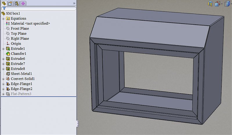

what are you trying to do with this model? typically the flange is for sheet metal parts, that part does not look like it can be created as a sheet metal part.
you should be able to draw your flange as a sketch, and use this for your geometry. If its possible and you would like to post or send me the file i can play around with it. What is the part? It almost looks like it will be some sort of hvac setup for a filter
I would agree a miter flange should be smart enough to deal with different angled sides. That would seem occasionally common. I played with this quite a bit and couldn’t come up with a “good” way. I got a somewhat acceptable part with the new “convert to SM”. The relief’s and gaps are a little screwy and I don’t see any controls to change them.

when you are selecting your edges with the convert feature, there is an option all the way at the bottom to change the reliefs/tears. i think there are 3 or 4 options with a percentage value you can add in. While the parts i design typically dont have the reliefs as large as the software, they are typically driven by the thickness of the material and edge radius you enter.

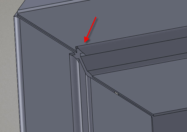

Those options didn’t change the goofy areas. Here’s a pic of a goofy relief. Covert added relief where it didn’t need it.

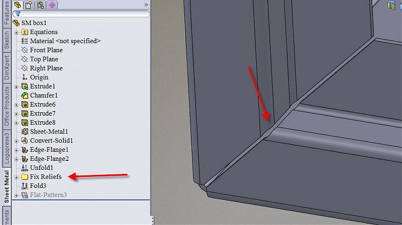

One great thing about SW sheet metal is that you can unfold bend(s)… then manually fix relief’s by cutting and extruding new pieces… then refold the part. You can generally make the part perfect, folded and flat… even compensate for stretching and development. It might be tedious but in the real world when you need something, you need it.

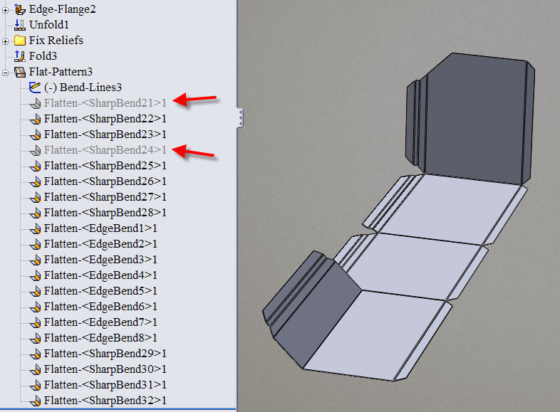

You can alter the flat blank under the “Flat Pattern” feature too. And you can suppress flattened bends to see the part being folded one bend at a time.

Ramsay: what JD said. Then type “ctrl-Q” to force a complete rebuild. Rolling up the “end of part” bar makes the file a blank part with the feature instructions… but not the features. I didn’t know about the mesh adding so much to the part size but it makes sense. Part file sizes are huge, but when it is exported to .X_T it’s small. I would guess the .X_T doesn’t save the mesh.
Shift… yeah, the new convert to SM is very intuitive. I actually made the whole part using it, but there were more goofy reliefs, so I added the flanges instead. They built in individual on-screen radius and gap controls, but there is no way to Lap instead of Gap. I tried using “Rip” before “convert” with some success. If they made the software perfect no one would upgrade.
