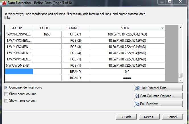

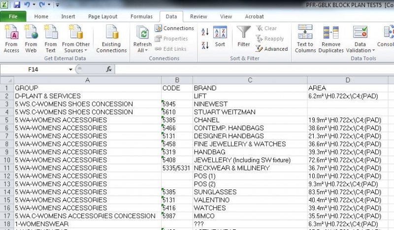

Corro Posted March 16, 2016 Share Posted March 16, 2016 Hi Lee We are extracting the attribute data to an Excel spread sheet, but the formatting is being included with the data, refer attached screen grabs. Is there a way to resolve? Thanks again Quote Link to comment Share on other sites More sharing options...
Lee Mac Posted March 16, 2016 Share Posted March 16, 2016 We are extracting the attribute data to an Excel spread sheet, but the formatting is being included with the data, refer attached screen grabs.Is there a way to resolve? Thanks again Unfortunately not, as AutoCAD is not expecting to find MText formatting codes within attribute content (for the reasons I have given above). Quote Link to comment Share on other sites More sharing options...
