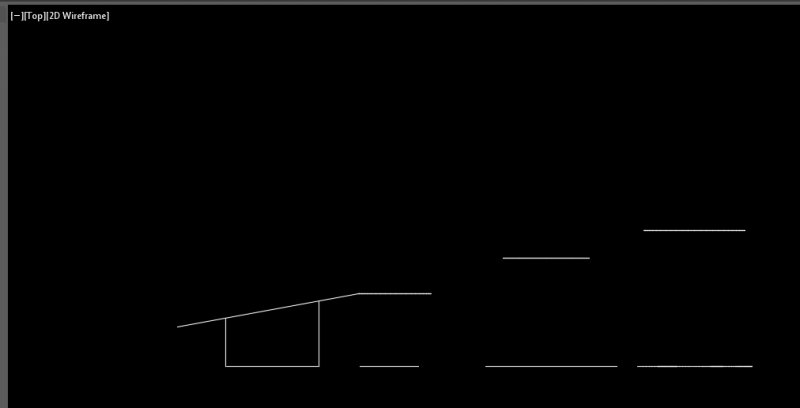

I'm working in top view, I attached some polygons cutted by lines.I'm trying trimming these polygons using these lines.So, I select trim command, next the line and finally I select the polygon, but isn't working.Note that I rotated the axes previously, but I'm still working in x,y.See the attached figure and the previous dwg file
I opened your drawing and without changing the UCS or the view in any manner I was able to trim the two circles and the polygon using the straight and curled lines. Still don't see any problem.
You are working in the front view. This is the top view. As you can see you have Z values in what appears to be a 2D drawing. Also, check the options in the trim command. If Projection is set to none, you won't be able to trim.
