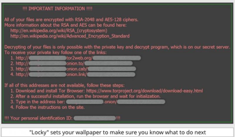

Our IT department just sent out this warning.
There is a new virus called “Locky” that has already infected over 400,000 workstations. There are 4000 new infections per hour. Antivirus manufacturers are scrambling to catch up but it may take days for them to create a way to detect and block it.
The virus is spread by Word files in emails. They use social engineering (commonly pretending to be an invoice) to get you to open them and to run macros.
Do not open a Word file form anyone than you do not know, or Word files that you were not expecting. Under no circumstances run macros in any Word files.
Luckily there is a signature to these particular malicious emails:
The subject is “ATTN: Invoice_J-
The attachment is called “invoice_J-.doc”
Example: Subject: ATTN: Invoice J-11256978
Example: Attachment: invoice_J-11256978.doc
This is how it works:
You receive an email containing an attached Word document.
• The document looks like garbage.
• The document advises you to enable macros “if the data encoding is incorrect.”
• If you enable macros, you don’t actually correct the text encoding (that’s a trick); instead, you run code inside the document that saves a file to disk and runs it.
• The saved file serves as a downloader, which fetches the Locky ransomware program from the Internet.
• This then encrypts all of the data that you have access to, including shared folders and renames them with an extension of “.locky”
• The program then changes your wallpaper to be the ransom message shown below, demanding payment to get your files unlocked.
As I said above, Anti-Virus can't stop these because as far as the AV is concerned its just a word file attached to an email.
They could conceivably scan inside the file contents, but to do this with every file would slow your PC down to the point of unuseability.
Luckilly, as quoted above by SLW210, it does take some user actions to launch them, so there is a chance of spotting them before they can get to work.
However you are always going to get someone who blithely clicks away following the on screen instructions.
(and no doubt ransomware will soon evolve so that it can launch itself without any enabling of macros).
Anti-Exploit doesn't even look at files, it monitors what is being written to memory and/or storage and flags/stops any suspicious activity.
Your best defences against this type of attack are:
  • Install an Anti-Exploit as well as your Anti-Virus; there are free or paid versions for home use, and paid for versions that will protect your business network.
  • Back up your data to removable media everyday, twice a day for perference.
  • And remove the media after backing up. If its not in the drive it can't get infected/encrypted.
    These ransomware attacks are an epidemic at the moment; take extra precautions.
