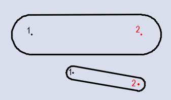

Happy Hobbit Posted February 15, 2016 Share Posted February 15, 2016 It’s relatively straight forward to code a rectangular GRRDRAW function as below, which draws a rectangle from the middle of one side. Does anyone know if it’s possible to create a GRRDRAW function so that it appears to have an ARC at one or both ends (as picture) without GRRDRAWing lots of small segments (lines) all of which would need coordinates built into the code. I don’t need the code to actually draw the shape, just the GRRDRAW part of it. (defun c:test (/ pt1 pt2 pt3 pt4 pt5 pt6 wid) (setq wid (getint "\Width? <10>")) (if (= wid nil) (setq wid 10)) (if (setq pt1 (getpoint "\nSelect 1st point")) (progn ;(command "circle" pt1 4.0) (while (not (= (car (setq pt2 (grread t 15 0))) 3)) (redraw) (if (listp (setq pt2 (cadr pt2))) (progn (setq pt3 (polar pt1 (* pi 0.5) (* wid 0.5)) pt4 (polar pt1 (* pi 1.5) (* wid 0.5)) pt5 (polar pt2 (* pi 0.5) (* wid 0.5)) pt6 (polar pt2 (* pi 1.5) (* wid 0.5))) (grdraw pt3 pt4 1 3) (grdraw pt3 pt5 1 3) (grdraw pt4 pt6 1 3) (grdraw pt5 pt6 1 3) ) ) ) ) ) (command "_pline" (list (car pt3) (cadr pt3)) (list (car pt4) (cadr pt4)) (list (car pt6) (cadr pt6)) (list (car pt5) (cadr pt5)) (list (car pt3) (cadr pt3)) "C") (redraw) (princ) ) Quote Link to comment Share on other sites More sharing options...

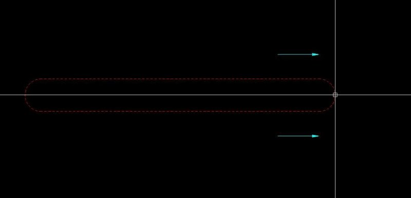

Lee Mac Posted February 15, 2016 Share Posted February 15, 2016 Here's an example using grvecs. As the function names suggest, grdraw & grvecs can only create vectors, therefore the arcs are created using multiple line segments. Quote Link to comment Share on other sites More sharing options...
Happy Hobbit Posted February 15, 2016 Author Share Posted February 15, 2016 It would however have been nice to just have the grdraw for a shape rather than one which actually draws the shape. **MODERATOR** Please change the title of this thread to 'GRDRAW with ARCS' , makes it easier for people to search. Sorry about the typo Addendum: Ah, only just noticedyour thread Lee, that code looks quite easy to incorporate into the code in my first post above. Simply replace the first point with a polar function from a defined point, the second point can probably be done the same way.... I think... Quote Link to comment Share on other sites More sharing options...
Lee Mac Posted February 15, 2016 Share Posted February 15, 2016 Here's another example which may also be of some interest: Circle Tangents. The above includes grarc & grcircle functions and also demonstrates how to implement a form of Object Snap within a grread loop. Quote Link to comment Share on other sites More sharing options...
Happy Hobbit Posted February 15, 2016 Author Share Posted February 15, 2016 Aha! Looks perfect Lee. I'd already seen a reference to it under the heading Grsnap but couldn't find the code for the demo! Thank you very much indeed Quote Link to comment Share on other sites More sharing options...

Nikon Posted November 22, 2023 Share Posted November 22, 2023 Good day everyone! Lisp Stefan M. (15.02.2016) draws a slot with a given width and binding to the first point. Someone can add a binding to the second point to this lisp. Thank you in advance. Quote Link to comment Share on other sites More sharing options...

Nikon Posted November 24, 2023 Share Posted November 24, 2023 (edited) 1. select 1 snap point (arc center) 2. specify the width between straight lines (or the radius of the arc, Arc=W/2) 3. specify the 2nd snap point It is desirable that it be a single polyline (closed outline). Or if, it's easier. Create a slot with the specified width (Rar c=W/2) between the two selected points. SLOT.dwg Edited November 24, 2023 by Nikon Quote Link to comment Share on other sites More sharing options...

marko_ribar Posted November 29, 2023 Share Posted November 29, 2023 (edited) This is way better than my approach... https://www.theswamp.org/index.php?topic=58809.0 (defun c:slot ( / cmd dict ent lastent obj prev ss vals vars *error*) ;; ----------------------------------------------------------- ;; ;; Draw Slot 29-11-2023 by dexus ;; ;; ----------------------------------------------------------- ;; ;; https://www.theswamp.org/index.php?topic=58809 ;; ;; ----------------------------------------------------------- ;; ;; Draw a slot with preview ;; ;; Prompts user for radius, startpoint and endpoint ;; ;; Global variable 'slot:rad' for last radius ;; ;; ----------------------------------------------------------- ;; (defun *error* (msg) (and vals (mapcar (function setvar) vars vals)) (or (wcmatch (strcase msg t) "*break,*cancel*,*exit*") (princ (strcat "\n* Error: " msg))) (princ) ) (setq vars '("cmdecho" "peditaccept" "qaflags") vals (mapcar (function getvar) vars) dict (cdar (dictsearch (namedobjdict) "acad_mlinestyle"))) (mapcar (function setvar) vars '(0 1 0)) (initget 6) (if (cond ((not (setq slot:rad (cond ((getdist (if (numberp slot:rad) (strcat "\nSpecify slot radius <" (rtos slot:rad 2 3) ">: ") "\nSpecify slot radius: "))) (slot:rad) ) )) (princ "\nNo slot radius chosen.") nil ) ((not (setq ent ; Create MLineStyle (list '(0 . "MLINESTYLE") '(100 . "AcDbMlineStyle") '(2 . "SLOT") '(70 . 1088) '(3 . "") '(51 . 1.5708) '(52 . 1.5708) '(71 . 2) (cons 49 slot:rad) '(62 . 256) '(6 . "BYLAYER") (cons 49 (- slot:rad)) '(62 . 256) '(6 . "BYLAYER") ) ))) ((setq prev (dictsearch dict "slot")) ; If Slot exists, entmod (entmod (cons (assoc -1 prev) ent)) t ) ((dictadd dict "SLOT" (entmakex ent)) ; Otherwise create Slot t ) ((princ "\nCreation of mline failed...") nil) ) (progn (setq lastent (entlast) cmd (getvar 'cmdecho)) (setvar 'cmdecho 0) (princ "\nChoose first point: ") (command "_mline" "_j" "_z" "_st" "SLOT" "\\") ; Create Mline (princ "\nChoose end point: ") (command "\\" "") ; Get endpoint of Mline (if (not (equal lastent (setq obj (entlast)))) (progn (setq lastent (entlast) ss (ssadd)) (command "_explode" obj) ; Explode Mline (while (> (getvar "cmdactive") 0) (command "")) (while (setq lastent (entnext lastent)) (ssadd lastent ss)) (command "_.pedit" "_m" ss "" "_j" "0.0" "") ; Convert to polyline (setq ss nil) ) ) (setvar 'cmdecho cmd) ) ) (mapcar (function setvar) vars vals) (princ) ) Edited November 29, 2023 by marko_ribar 1 Quote Link to comment Share on other sites More sharing options...
Nikon Posted November 30, 2023 Share Posted November 30, 2023 (edited) Yes, the dynamics are from Stefan M. and the bindings are from marko_ribar. Great job! Command: SLOT Specify slot radius <200>: and in fact 4000??? 20 times more!? Edited November 30, 2023 by Nikon Quote Link to comment Share on other sites More sharing options...
