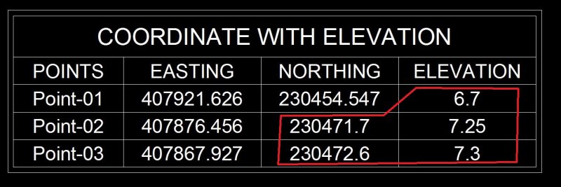

hi,
Please go through this code and I'm confused below mentioned highlighted area. Actually it I was trying to edit one of my previous lisp, for bringing Z value with X,Y coordinate.

  bijoymano said:
hi,
;; Command: CN, CSN, RES, CRT ;;
hi newbie should read this

In your sub function: CRTable
change this
;;;		(while (/= COLEN COM)						;
;;;			(setq COM1 (substr CORD COM 1))				;finds ',' in strings for
;;;			(if (and (= COM1 ",") (= GAP 1)) (setq S1 COM GAP 2))	;spliting string
;;;	 		(if (and (= COM1 ",") (= GAP 2)) (setq S2 COM))		;
;;;			(setq COM (+ COM 1))				;
;;;		) ;while
;;;		(setq CODE (substr CORD 1 (- S1 1)))		;;;strips of code
;;;		(setq SON (substr CORD (+ S1 1) (- S2 S1 1)))	;;;strips of north
;;;		(setq SOE (substr CORD (+ S2 1) (- COLEN S2)))	;;;strips of east
;;;	 	(setq SOL (substr CORD (+ S2 1) (- COLEN S2)))	;;;strips of elevation *******
to
(mapcar 'set '([b][color="red"]CODE SON SOE SOL[/color][/b])([color="blue"]LM:str->lst [/color][color="red"][b]CORD[/b][/color] ","))
or you can use this alternative
(mapcar	''((a b) (set a (vl-princ-to-string b)))
'([color="red"]CODE SON SOE SOL[/color])
(read (strcat "(" (vl-string-translate "," " " [color="red"]CORD[/color]) ")"))

  bijoymano said:
Thank you friends now its working :)
but your code tag not working?

Thank you so much for your support. here I'm attaching my final code.
For fine tuning I need one more help to avoid "0" suppression. already given (setq SOZ (rtos (caddr CORD) 2 3)) code for 3 digits in function "CRT" but I need to avoid zero suppression.
(setvar 'dimzin 0)
Try --> LM:rtos
