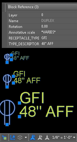

Here's your proof. Each instance of the block is assigned a different annotation scale. Each block has only one scale assigned to it. If there is more than one scale assigned to any instance, this does not work for that instance.
The setting I was referring to was ANNOALLVISIBLE.

You know Rob, you are correct. The thing I was missing conceptually, is that the annotation scales are assigned to each inserted instance of the block, rather than to the block entity itself. I have not used annotative blocks even one time, and for some reason I had an incorrect concept that somehow they were different.
I'd say that I had been wasting everyone's time, except that after all of this we, especially me, have learned something.
After 7 years of using annotative dimensions and multileaders, and doing this very thing with them, this morning it dawned on me that a dimension is after all, just another block.
