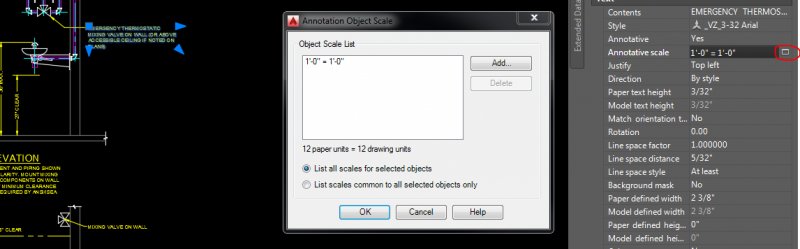

MEPGuy Posted February 11, 2016 Posted February 11, 2016 I was just working with annotative blocks recently and came across and issue that I cant seem to find the solution for online or if it is even possible. I am looking to create multiple instances of the same block at different annotation scales in the model space of a drawing. Let me give a quick example below: Lets say I have an electrical power plan layout with multiple receptacles and I would like one receptacle at 1/4"=1" scale and another receptacle (same block as the first) at 3/16"=1" scale. Is there a way to accomplish this in the model space? Currently when I change the annotation scale for the whole drawing all the block scales are updated, I would like to individually control the scale for each separate block. The reason i'm hoping this is possible because if I create a detail in the model space then chances are that it to be at a different scale then the rest of the drawing. I know that this can be accomplished in the view port paper space but was just wondering if there is a way to do this in the model space. Thank you in advance for your help! Quote

RobDraw Posted February 11, 2016 Posted February 11, 2016 So there is no way set the different blocks to individual scale in model space? Why you give up so easily? If you are going to be changing the scale in model space, you are going to need to turn off ANNOAUTOSCALE to prevent automatic adding of additional scales. I think it would be best for you to work through viewports. That way you are working with only one scale at a time and won't need to keep switching the model space scale. If the objects only need to be shown at one scale, delete any other scales from those objects to prevent them from showing at the other scales. Quote
MEPGuy Posted February 11, 2016 Author Posted February 11, 2016 I know that I can scale the blocks manually. I was more so curious about weather or not I can have different items at different annotation scales in the model space. It seems that it will not really be possible and i'm better off setting the annotation scales in the view ports. Unless i'm missing something? Thanks. Quote
RobDraw Posted February 11, 2016 Posted February 11, 2016 It is absolutely possible with ANNOAUTOSCALE turned off. I only suggested working through the viewport to make it easier on you. Quote
MEPGuy Posted February 11, 2016 Author Posted February 11, 2016 how would I set the annotation scale on a specific item? I can't seem to find a way to set the scale on an individual block Quote
MEPGuy Posted February 11, 2016 Author Posted February 11, 2016 The properties box just displays the annotation scale that the drawing is set to, i can't manually change it for each block. However the blocks scale just fine when the annotation scale is changed in the model space so I don't think its an issue with the blocks. Quote
RobDraw Posted February 11, 2016 Posted February 11, 2016 Yes, you can. Hit the icon to the right of the scale. Quote

RobDraw Posted February 12, 2016 Posted February 12, 2016 ANNOALLVISIBLE is the variable to allow you see all annotation scales in a view. Quote
Dana W Posted February 13, 2016 Posted February 13, 2016 (edited) That is not true. There is a variable to show all scales, isn't there? I'll check when I get in the office.Yes, there is a variable, ANNOALLVISIBLE = 1, to show all annotative objects all the time, but it has no bearing at all on which scale is assigned to which object, it just displays all of them no matter what their scale is. However that is not what the OP wants. See post #1, paragraph #2. They want block "A" to have more than one annotative scale assigned to it, lets say two scales. They will insert block "A" at two different places in modelspace. They want one instance of block "A" to appear at one scale, and only that scale, and the other instance of the same block "A" to appear at the other scale and only that scale. The two instances of the same block are desired to appear each at a different single annotative scale simultaneously. This cannot be done using annotative scaling. With annoallvisible = 1, you can see two different blocks at two different scales, but one block will always display at the same scale in two different instances of the block. Which of the two scales are assigned to our one block? Both scales are. Edited February 13, 2016 by Dana W Quote

RobDraw Posted February 13, 2016 Posted February 13, 2016 They want block "A" to have more than one annotative scale assigned to it, lets say two scales. They will insert block "A" at two different places in modelspace. They want one instance of block "A" to appear at one scale, and only that scale, and the other instance of the same block "A" to appear at the other scale and only that scale. The two instances of the same block are desired to appear each at a different single annotative scale simultaneously. This cannot be done using annotative scaling. Yes it can be done. Tested and approved. Quote
