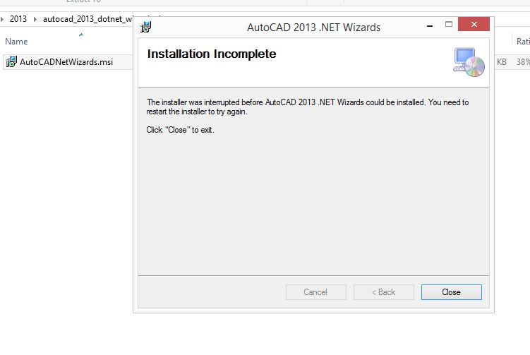

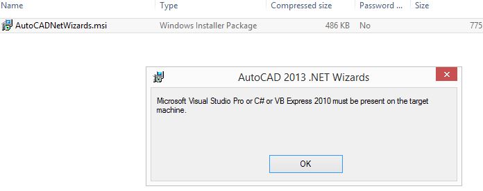

Following happens when I try to install this wizard
I have :
1.Visual Studio Community 2015
2.Autocad 2013
3.File named autocad_2013_dotnet_wizards.zip (failed to install)
4.File named ObjectARX_2013_Win_64_and_32Bit.exe (installed C:\ObjectARX 2013)
5.File named objectarx_wizards_2013.zip (failed to install) same problem as on the attached images.
Please give me the simple instructions on how to resolve my problem. Googling didn't give me the answers.

Had to install visual basic express 2010 and then run it as administrator from command prompt . I'm so happy you are not gonna believe it NoroZorro
That's what the first message asked you to do. 8)
