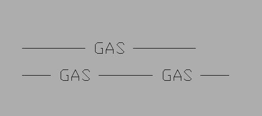

If you use the Gas linetype that comes with AutoCAD, it seems able to centre itself.
Perhaps it would be better to try and write your own linetype definition, rather than let a programme mkltype add its own take on matters!
Or you could "borrow" AutoCAD's hot water linetype definition and substitute your "UE" for the "HW" and test it. If it looks good then you're all set.

No.
As a simple example, if you have a linetype definition that says draw a 1 unit dash and a 1 unit gap, and repeat, how do you want it to appear on a line that is 6.7 units long?
The A alignment code ensures that each interior dash and gap are exactly 1 unit long. The starting and ending segments are the ones who are modified (lengthened or shortened)
The S alignment code distributes the extra space among the dashes and gaps (with the unfortunate side effect of ending with a gap in this case)
*A-Align-Code, __ __ __ __ __ __ __ __ __
A,1.0,-1.0
*S-Align-Code, __ __ __ __ __ __ __ __ __
S,1.0,-1.0
Having TEXT in the linetype makes no difference here. The same rules apply. As you say, unless the entity "isn't a perfect multiple of the line type", then something has to be modified.
